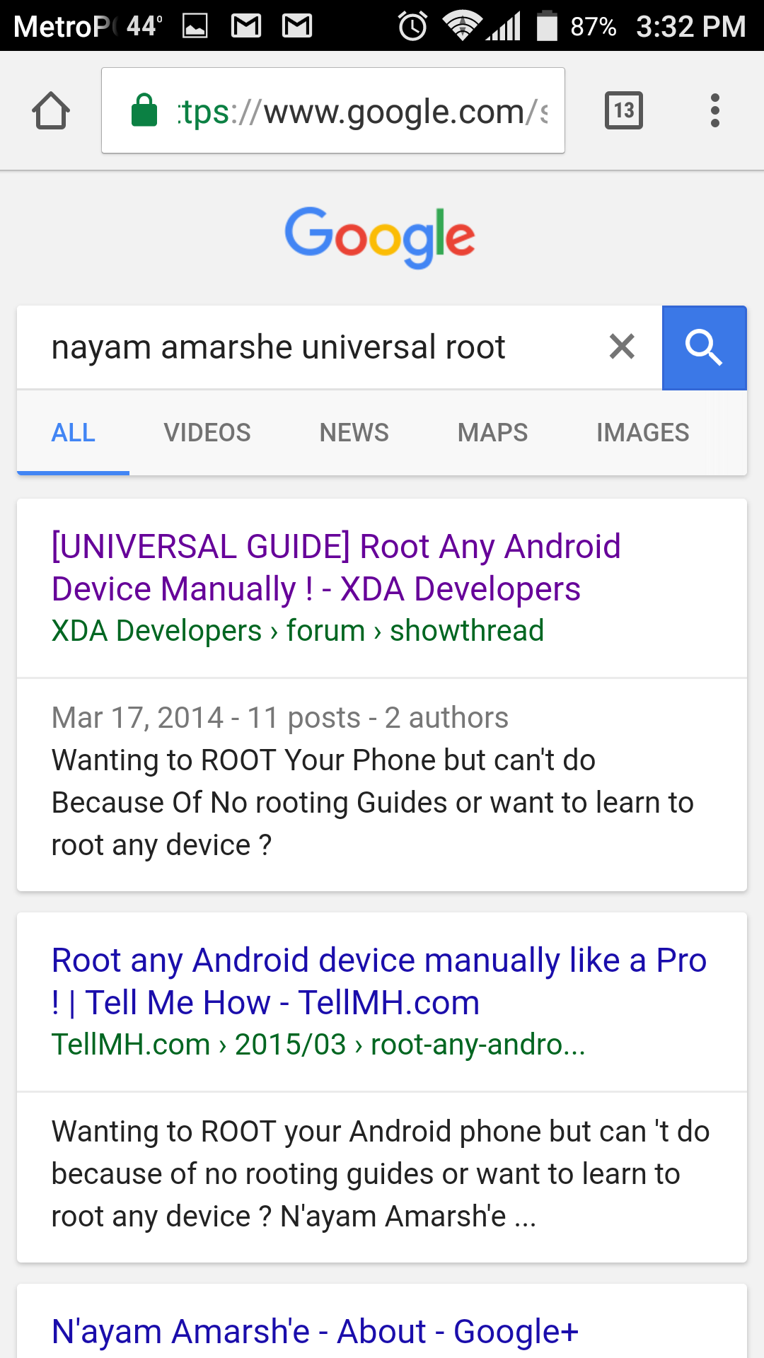

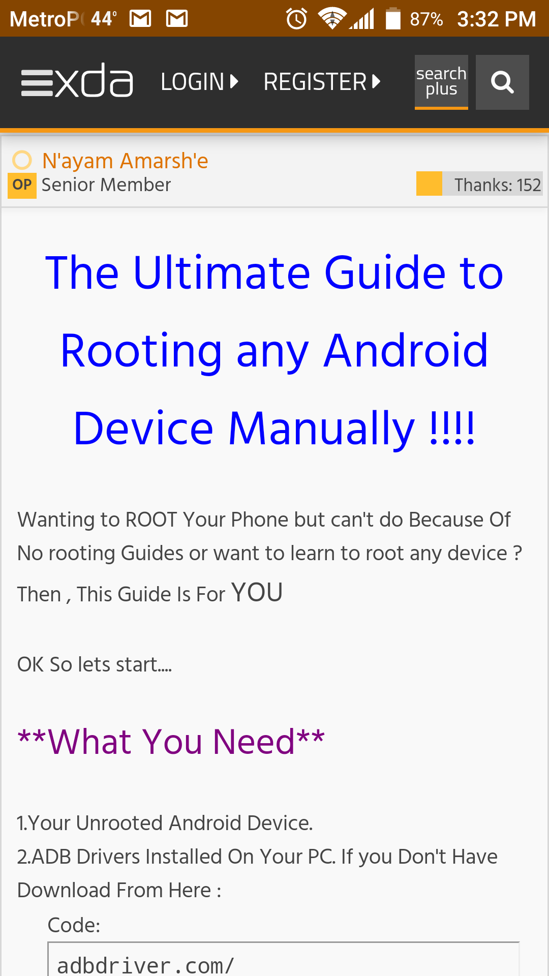

Just google search for it..
It won't work the device is system write protected. It will take an extremely knowledgeable dev to root this device. Someone like jcase and he's never gonna help us so just keep praying for a miracle and hope KingRoot at least comes up with an exploit that can give us temp root so we would at least have a start.

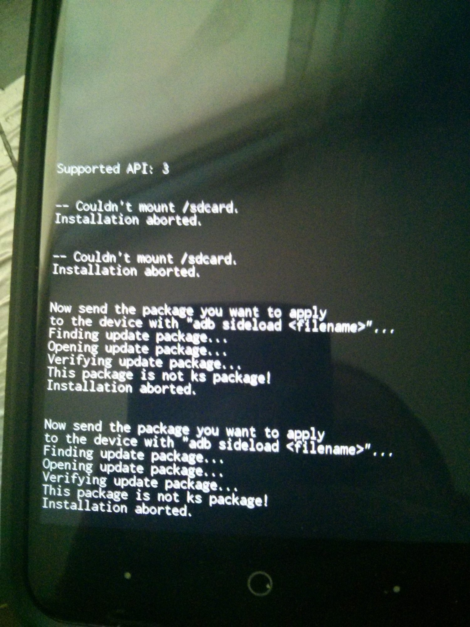

This appears to be only for another ZTE device. I highly doubt this will work as all signed updates are signed with ZTE keys for the specific phone. I will go ahead and try though.
ADB sideload failed. I will be trying the SD method instead.
SD method failed too. It states that the update is not for this phone - as expected.

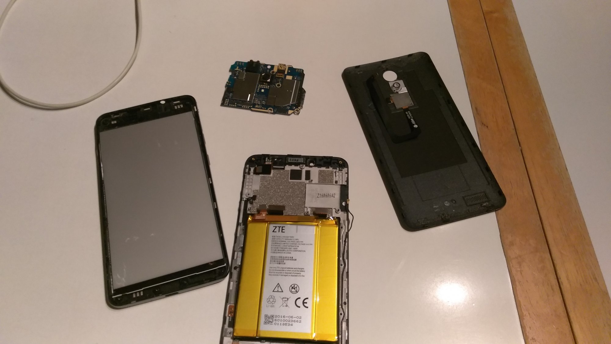

Can't sign our own updates without the private keys that ZTE uses. However, I found the Qualcomm USB tool and it detects the ZTE Zmax Pro when in DFU mode. Anyone got any ideas?
Click Down Arrow on Top-right then you can change it to English. But that's pretty much about it :( We got nothing to flash.. no firmware...
We do have a recovery.... it's untested and I'm not going to risk it. I'm very tight on money. This is Messi's chance to finally claim his root bounty and make us all happy. Hope he quadruple checks that he ported TWRP properly so he does not brick his device.
I am going to attempt to do a full backup of the system partitions and upload them to mega for the good of us all. It finally seems we are at the end..
**EDIT**
The memory dump is failing. The Sahara memory dump fails and causes a reboot. Perhaps I should try another qualcomm flashing utility.
