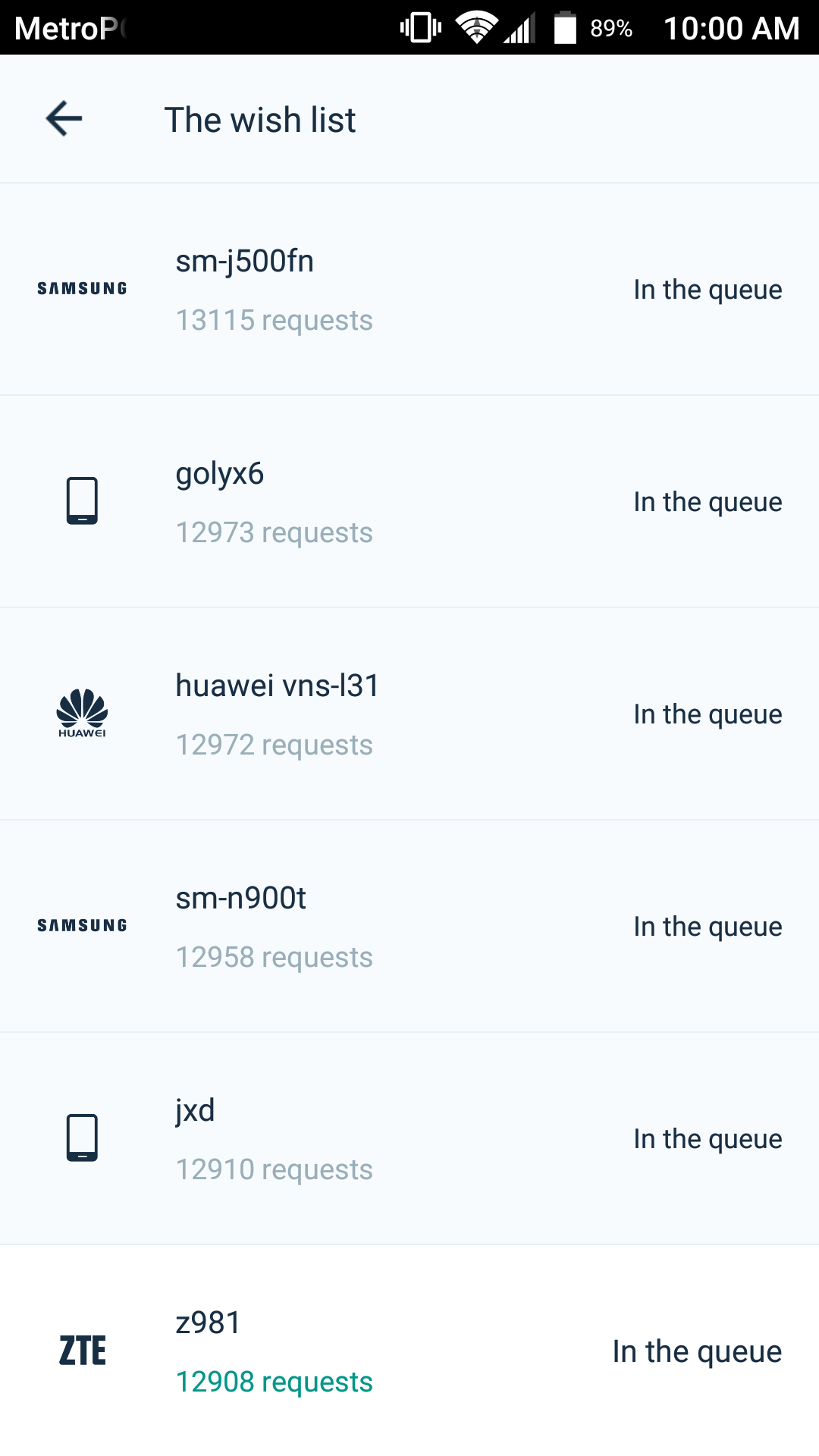

Just to give a KingRoot request update. But other than that. Is there anything I can do. I have been updating the mixer file and other configurations for better performance and volume but unable to currently test
