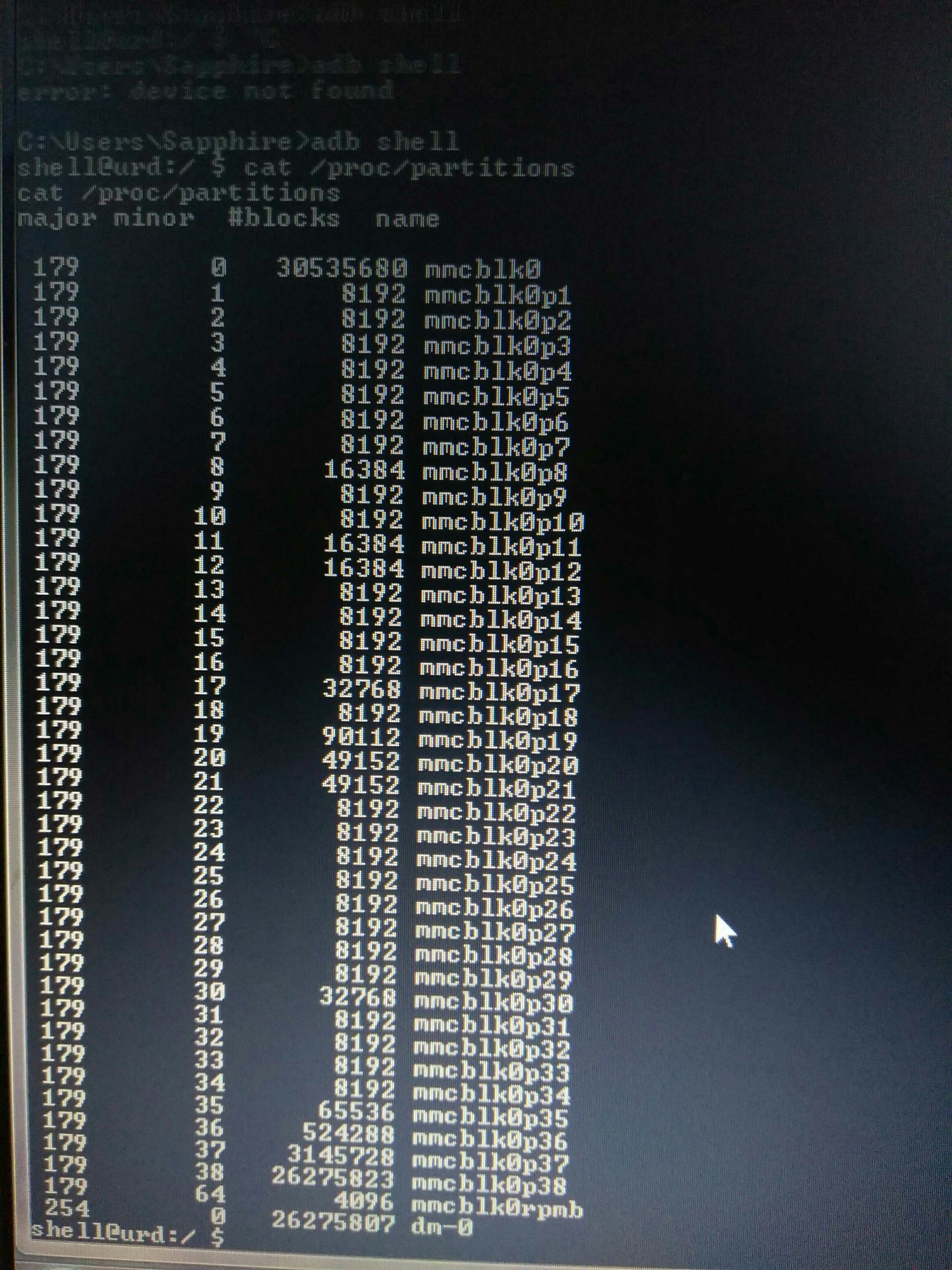

So we can not officially write in FTM mode, but FTM gives adb shell access to which you can send and write and pull recovery via adb shell.
If you can write a new recovery you will be able to get system access to root. What we did before was pull both the bootloader and recovery images and write the bootloader to the recovery and recovery to the bootloader.
This way we would have system read/write, but i would not advise trying that till you have a twrp/recovery to use to fix the phone.

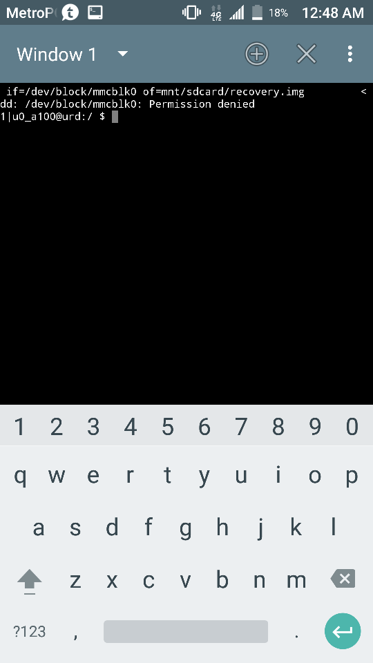

dd permission denied. Hmm...
They may have finally closed off access via FTM.
Have you tried reading via normal mode? Aka OS.
You may have to try different modes.. The main worry right now is if you can write since you can pull the recovery via the ota file.

Seems FTM mode is locking down partitions. That, or I did something wrong.

DD itself is locked down. Just tried dd'ing a text file from storage to storage, and got permission denied.
*Edit I made a mistake. Dd is not locked down.
Disregard my last message. For some reason, I did /dev instead of /storage. dd is not locked down
