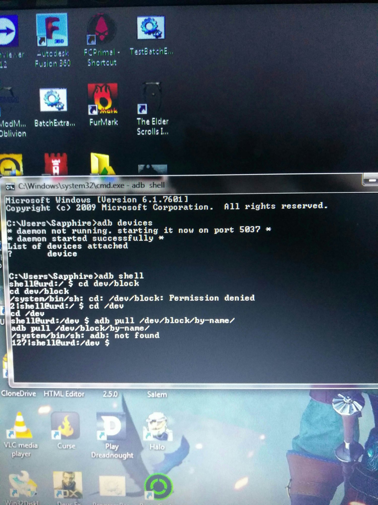

I can't write what I can't see. I'm in the shell right now, but FTM is throwing "permission denied" whenever I try to cd into /dev/block/by-name/ to try and find where the recovery partition is stored
If you know where the partition is, I'll try writing directly

Alright, so I think mmcblk0 stores the recovery image, but, everything /dev/block/ is read denied. Not sure about write.
Has no one pulled a OTA zip to read the updater-script to see where the recovery partition is??
You won't be able to read it directly. You will have to DD copy the partition to pull it.
Actually, that never occured to me. But yeah, let me load up Kali and I'll dd it
Also the largest block partitions will usually be system/data/storage/bootloader..
Recovery will be in the 8-15mb size so anywhere from 8k to 19k blocks
Looks like I have to tear apart one of the updates to find out where recovery is stored.
