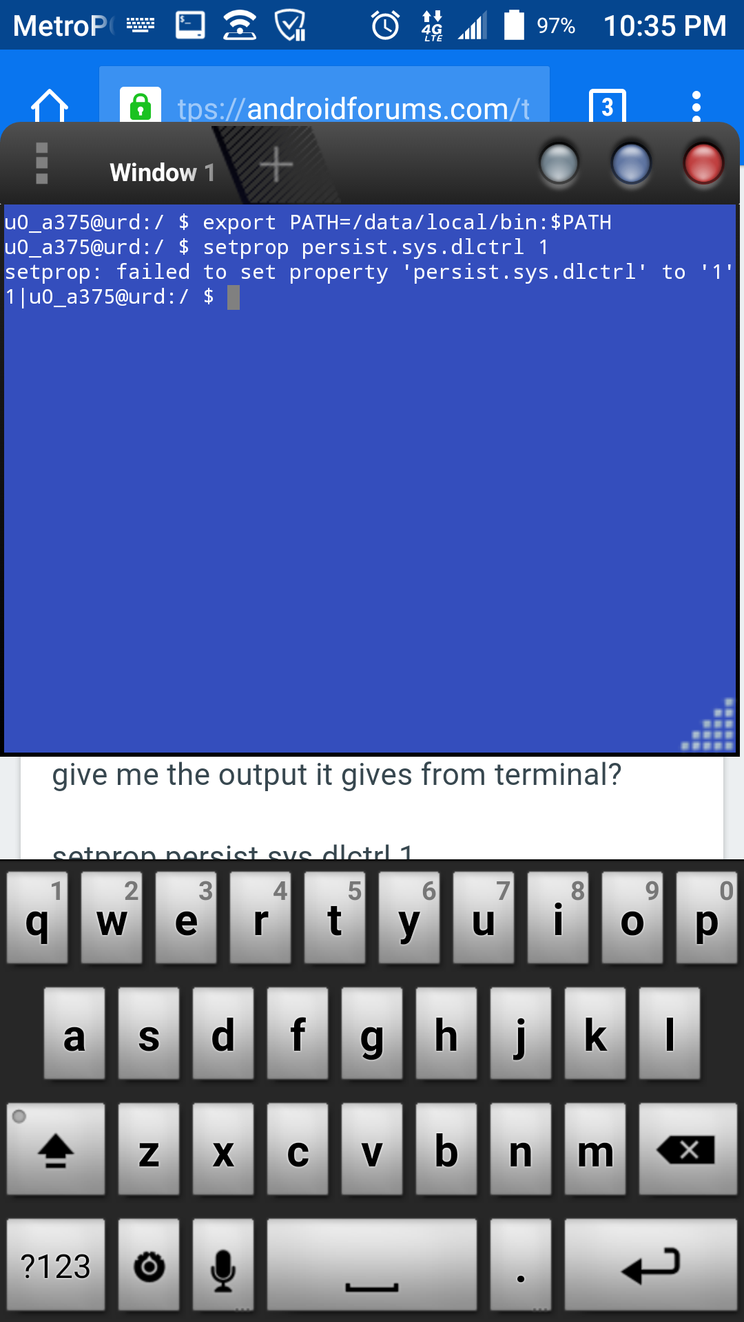

can someone please run this command and give me the output it gives from terminal?
setprop persist.sys.dlctrl 1[/QUOTE
I tried 2 ways. Setprop persist.sys.dpctrl. 1 and it said could not set blah blah blah then the second method which is the same thing as above except I added "set root" in front and it seemed to work how would I check?
if you ran it the same as i typed it and it produced a could not set then it did not work :(
u0_a152@urd:/ $ setprop persist.sys dlctrl 1
usage: setprop NAME VALUE
Sets an Android system property.
1|u0_a152@urd:/ $
you missed the . between sys and dlctrl
