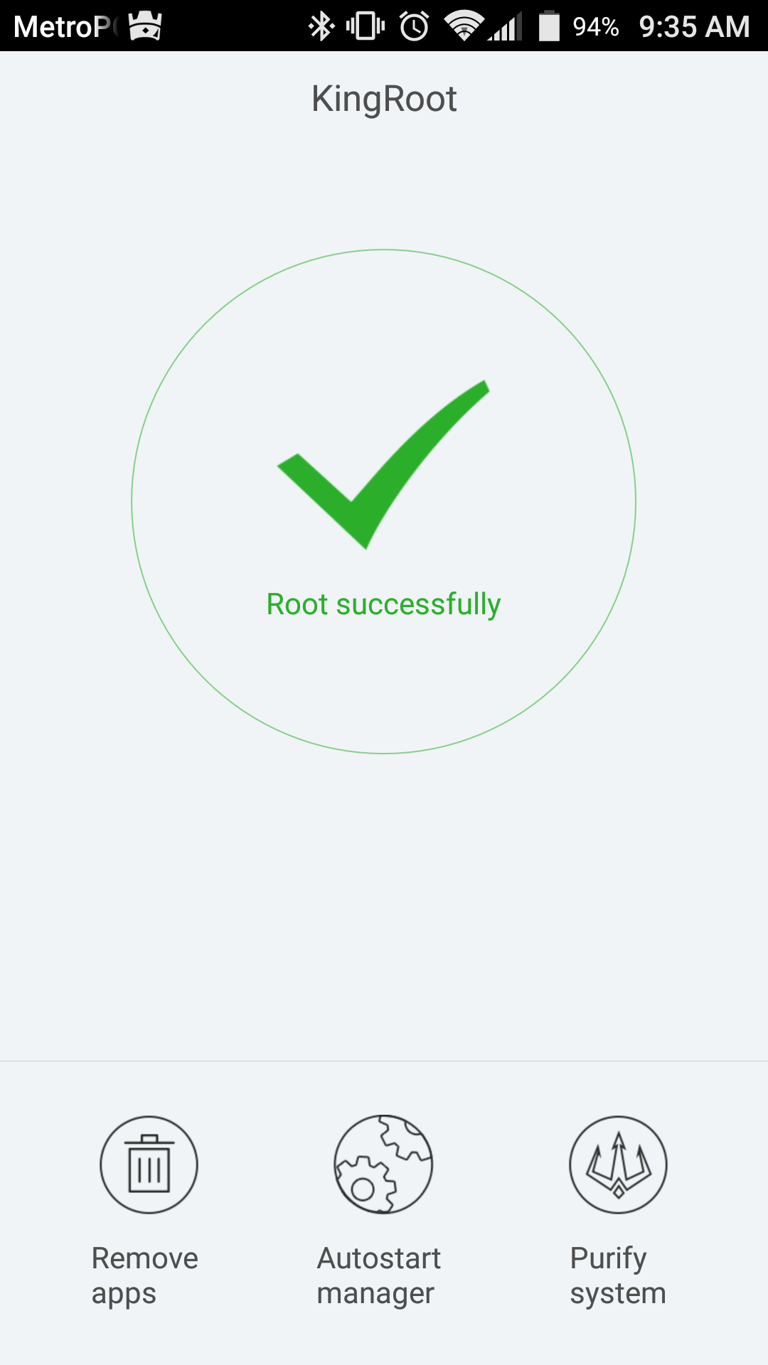

Hello, been viewing the forum quite sometime now, Impressive so far. Created an acct so i can say I have a..
ZTE Z981 build B08
and I tried the new kingroot V5.0.5 with no luck. It even said successfully rooted at the end, but it wasnt true. Stop around 70 percent. Ive also tried the windows desktop version with no luck.
