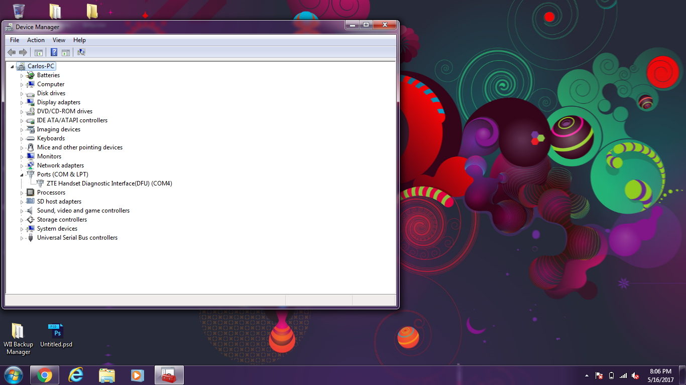

who else has managed to get into dfu mode ;) aka download mode

Nice wallpaper 😃
