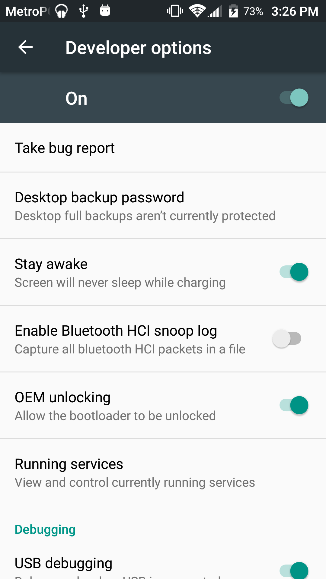

Also, did you guys notice you can unlock the bootloader in the developers menu? I don't know if that would help any of you at all, but you can.
That doesnt unlock the bootloader. Its Google's way of covering their butt if you do something wrong. All that clicking it does is acknowledge that you know the risks and are willing to allow whatever method the manufacturer uses to unlock the bootloader.
Actually sometimes that is exactly what it does. It all depends on the device.
True, although Id argue any device that unlocks that easily was never truly locked.
My point is that that is an Android menu. It is a generic acknowledgement that you are willing to allow your device to be unlocked. It doesnt actually unlock anything itself, it justs allows the phone to be unlocked. Its up to the OEM to then set the unlock procedure. It can be as easily as there is no procedure, or a long detailed process.
I hope zte begins to take the Motorola route and they give you the code to unlock the bootloader. Thats what I missed after my moto e (2nd gen) broke
We don't even know that this device's bootloader is locked at all, I'd say chances are that it's not.

So like some other phones this has OEM unlocking which is nice. I would like to know how you request research on the zmax pro on kingoroot (PC app) it just has restart and root for buttons never request research
