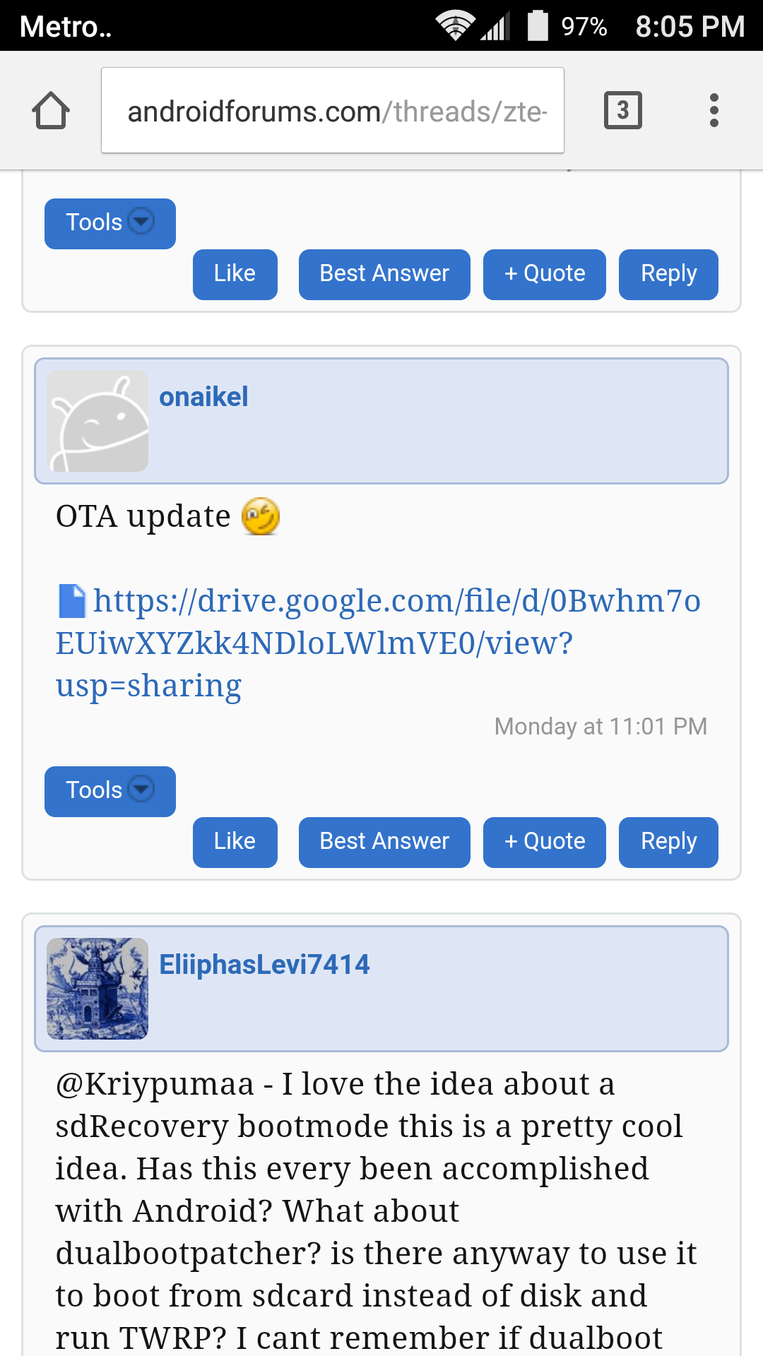

How does one catch the ota? to work on the signing issue at hand?

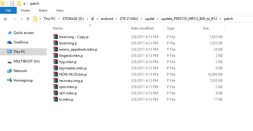

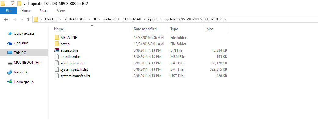

How did you guys extract the boot.img.p file in the .up file I extracted the update_P895T20_MPCS_B08_to_B12.up with winrar. What should I use to extract the boot.img.p file?
I have linked how it looks unpacked

So inside the update the folder \META-INF\ there are three files
  1. CERT.RSA
  2. CERT.SF
  3. MANIFEST.MF

# ---- start making changes here ----
ui_print("Patching system image after verification.");
show_progress(0.550000, 0);
block_image_update("/dev/block/bootdevice/by-name/system", package_extract_file("system.transfer.list"), "system.new.dat", "system.patch.dat") ||
    abort("Failed to update system image.");
show_progress(0.050000, 10);
ui_print("Patching keymaster.mbn image...");
apply_patch("EMMC:/dev/block/bootdevice/by-name/keymaster:177568:3ce6072b9916ed474b0894df8ca065bfdecf8f1e:177568:35f8381525ab8c92d575e17f181081b8a0067f44",
            "-", 35f8381525ab8c92d575e17f181081b8a0067f44, 177568,
            3ce6072b9916ed474b0894df8ca065bfdecf8f1e, package_extract_file("patch/keymaster.mbn.p"));
ui_print("Patching fingerid.mbn image...");
apply_patch("EMMC:/dev/block/bootdevice/by-name/fingerid:32852:068ac7141e4f542f152de1a73c2538261cf60ba6:32852:3b7cb8f151cffec7653fe829024e72744fdee033",
            "-", 3b7cb8f151cffec7653fe829024e72744fdee033, 32852,
            068ac7141e4f542f152de1a73c2538261cf60ba6, package_extract_file("patch/fingerid.mbn.p"));
ui_print("Patching adspso.bin image...");
package_extract_file("adspso.bin", "/dev/block/bootdevice/by-name/dsp");
ui_print("Patching rpm.mbn image...");
apply_patch("EMMC:/dev/block/bootdevice/by-name/rpm:166088:b401574da32636f9395ce3964eb1ba23fb5a0f5f:166088:9f41eb1cfad9b56a76617e079f6cd9bf44dfa8ec",
            "-", 9f41eb1cfad9b56a76617e079f6cd9bf44dfa8ec, 166088,
            b401574da32636f9395ce3964eb1ba23fb5a0f5f, package_extract_file("patch/rpm.mbn.p"));
ui_print("Patching NON-HLOS.bin image...");
apply_patch("EMMC:/dev/block/bootdevice/by-name/modem:76438016:de3acc0716a8053819b0bb50c02bb1da796da7a0:76585472:87747dc9371cc6503ac340fb55cf27a34b1dda36",
            "-", 87747dc9371cc6503ac340fb55cf27a34b1dda36, 76585472,
            de3acc0716a8053819b0bb50c02bb1da796da7a0, package_extract_file("patch/NON-HLOS.bin.p"));
ui_print("Patching tz.mbn image...");
apply_patch("EMMC:/dev/block/bootdevice/by-name/tz:632644:fbcf8dbae397d91f6f4fc5d6f4160880d36ab43b:632644:07023648051d47bb91463bb3a562dd6a5c2a384c",
            "-", 07023648051d47bb91463bb3a562dd6a5c2a384c, 632644,
            fbcf8dbae397d91f6f4fc5d6f4160880d36ab43b, package_extract_file("patch/tz.mbn.p"));
ui_print("Patching hyp.mbn image...");
apply_patch("EMMC:/dev/block/bootdevice/by-name/hyp:73728:eeb375641b66b96dc0336d0abd78e0f8e9b22e95:73728:1c2079d70a233d6117685920aeb3e909362bfbab",
            "-", 1c2079d70a233d6117685920aeb3e909362bfbab, 73728,
            eeb375641b66b96dc0336d0abd78e0f8e9b22e95, package_extract_file("patch/hyp.mbn.p"));
ui_print("Patching sbl1.mbn image...");
apply_patch("EMMC:/dev/block/bootdevice/by-name/sbl1:321952:7bbc1a2d7fd68ef08c3c036dded254459e083453:322976:abf067334f85bb7854b7241e973e884fc3b7ce7f",
            "-", abf067334f85bb7854b7241e973e884fc3b7ce7f, 322976,
            7bbc1a2d7fd68ef08c3c036dded254459e083453, package_extract_file("patch/sbl1.mbn.p"));
ui_print("Patching emmc_appsboot.mbn image...");
apply_patch("EMMC:/dev/block/bootdevice/by-name/aboot:891516:89f232cdc51a357933466f9e53b9c32e26e3c59b:902616:f689e5d837c772053fa3f9c344a521d8083b76e6",
            "-", f689e5d837c772053fa3f9c344a521d8083b76e6, 902616,
            89f232cdc51a357933466f9e53b9c32e26e3c59b, package_extract_file("patch/emmc_appsboot.mbn.p"));
ui_print("Patching cmnlib.mbn image...");
package_extract_file("cmnlib.mbn", "/dev/block/bootdevice/by-name/cmnlib");
ui_print("Patching boot image...");
apply_patch("EMMC:/dev/block/bootdevice/by-name/boot:35087544:532a00dec3cd779ede9c48a935de00a860cbe953:35312824:60a0891fdb09b392cc85ae1541e08a72f87c166a",
            "-", 60a0891fdb09b392cc85ae1541e08a72f87c166a, 35312824,
            532a00dec3cd779ede9c48a935de00a860cbe953, package_extract_file("patch/boot.img.p"));
ui_print("Patching recovery image...");
apply_patch("EMMC:/dev/block/bootdevice/by-name/recovery:33338556:c8f1b92d125277898c5a6deca3a541b126d919c9:33561788:1ea424ce307870c3fdd1577b2bd36bd08cfc70c4",
            "-", 1ea424ce307870c3fdd1577b2bd36bd08cfc70c4, 33561788,
            c8f1b92d125277898c5a6deca3a541b126d919c9, package_extract_file("patch/recovery.img.p"));
set_progress(1.000000);
Learn How to read/write these types of scripts
http://forum.xda-developers.com/showpost.php?p=25136429&postcount=2
This May Be Important to you people trying to bypass and inject files
I may have that entire thing wrong. I've been looking through sha1 hashes and those are some sort of encrypted hashes so you can't spoof the files. like in previous versions of android:(
I don't think this phone is gonna get root :(
