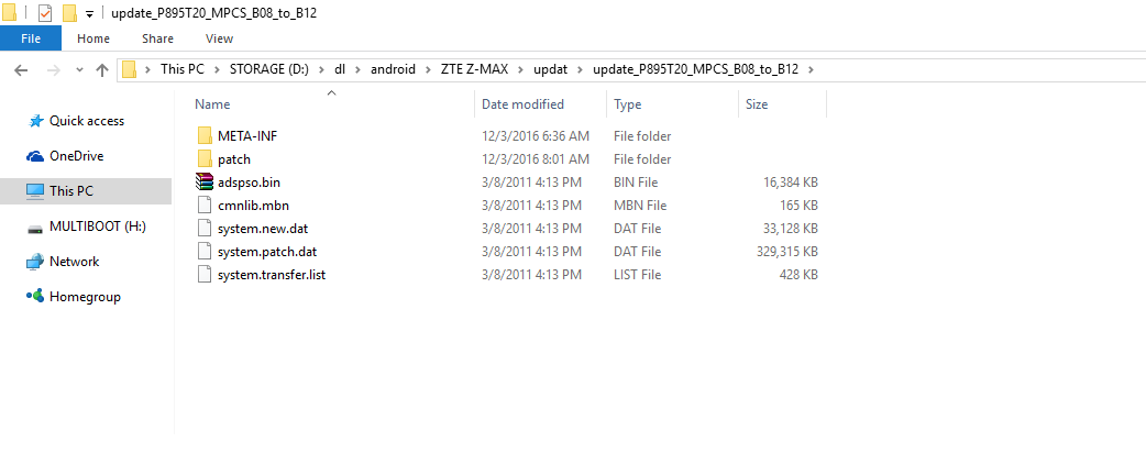

How did you guys extract the boot.img.p file in the .up file I extracted the update_P895T20_MPCS_B08_to_B12.up with winrar. What should I use to extract the boot.img.p file?
I have linked how it looks unpacked
View attachment 112624 View attachment 112625

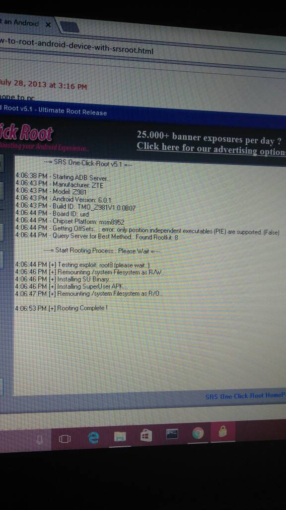

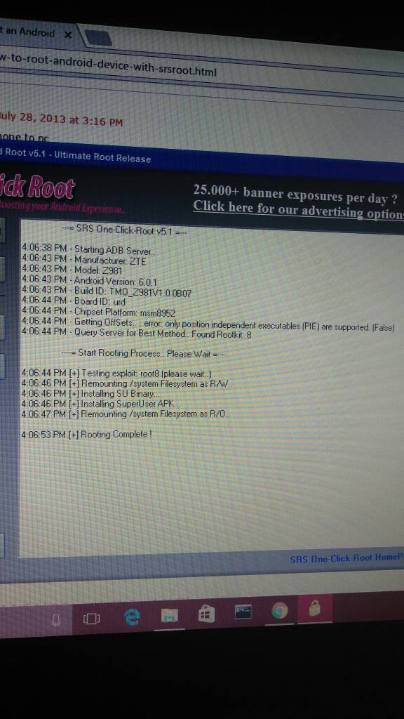

SRS root doesn't work on b12 update. Can't test on b08. But I have a good SRS root exe for someone willing to try
I just tried it and this it what it's saying. Although it's not sticking or it's installing something else entirely on the device. I'm also not on bo8.
