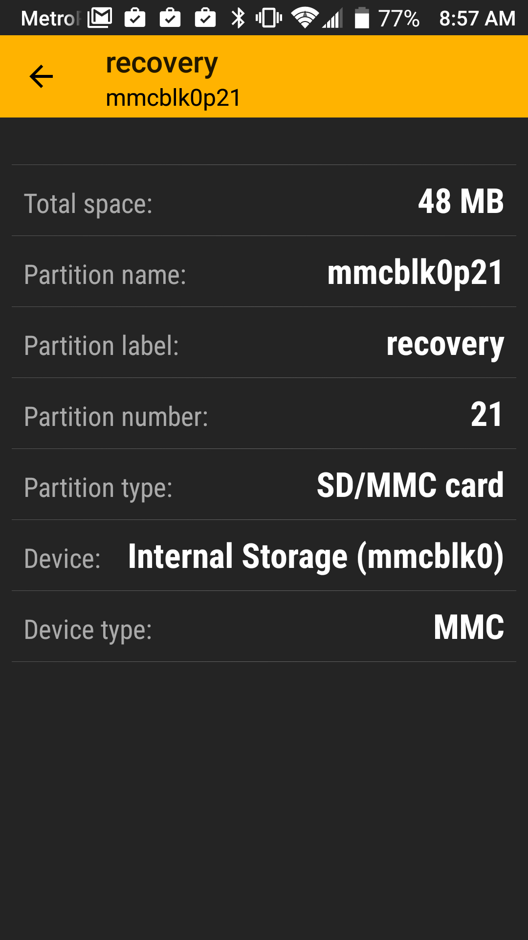

anyone know the recovery block device location?
adb shell
cat /proc/partitions
of course,
$ ls -al /dev/block/platform/dw_mmc/by-name
returns with permission denied.
