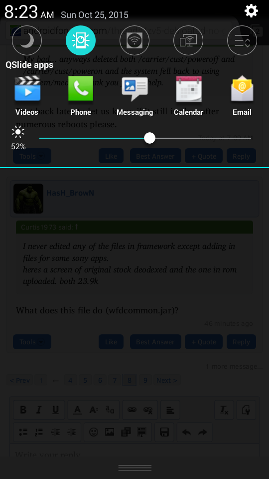

@Curtis1973 how did you mod the LG Quick Settings to not have the circle buttons? If it was in the systemui apk then I replaced it as the ZV6 update zip contained a patch. If it was G2 Tweaksbox then I couldn't figure it out.
From what I looked up online, it's part of the "WiFi Display" (hence the Wfd acronym) capabilities, such as Miracast. It shouldn't take up any resources unless your mirroring your LG Volt to a different display.
Post me a screen of the buttons you are talking about
He might of done it himself by modding the SystemUI apk. I used G2Tweaksbox for mine

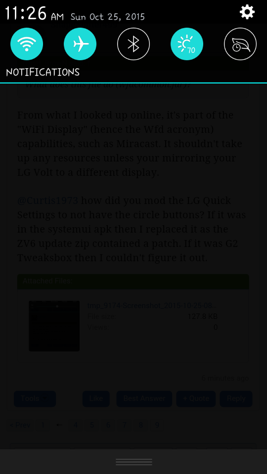

Ah that looks like the lg tribute quick settings panel. I edited those images using photoshop and put them back in LGSystemUI.apk. In drawable/hdpi. Just get them from the original LGSystemUI apk and put them in the new one. Now I made no edits to those in the lg volt and g2 tweaksbox doesn't have settings to edit those except for background color and transparency.
Did you decompile the SystemUI or did you just rename it as a zip and edited it from there?
No used winrar to open the apk then dragged drawble/hdpi to desktop and edited the images then used winrar to drag the changes back in. Winrar will ask how you want to save. Select store method.
What type of editing are you doing? Just resizes or??
Im asking so I can try and learn.
I sometimes do complete icon replacement,sometimes do a coloration like those on the tribute quick settings icons and sometimes i do resizing. Photoshop was my go to editor. Youll need a png editor plugin for it so you keep the formatting proper. Many people use gimp which is probably better for png as photoshop does not display those tricky border lines that android pngs use. Screw those up and your png will smear if its the type used in widgets,messaging apps with bubbles,etc. I stuck with photoshop even with issues because it was more familiar to me than gimp was.
A trick with photoshop in general is the copy paste method. In it you can paste another png over top the original as a layer,resize it to fit within the borders of the original then set the original layer opacity to zero,merge the layers and save. This will keep the original pngs formatting which makes for a quick and easy edit without the need to be particular with the formatting.
Thanks again
So following that, as long as the new layer(s) is(are) in the confines of the original border (even if smaller than), the original dictates the parameters. With that, we can make those wicked looking icons (transparency levels!!)
Yeah. If the png already supported transparency(in some cases even if it didnt but the xml doesn't state it will show with transparencies). As for what the original layer dictates its only applicable if you do not select "save as". Only save. Save as will throw away original formats and ask you to select format to save as meaning interlaced,etc. You can do this also but it requires you to really get the png layout correct. Or else smearing,stretching and other oddities will occur.

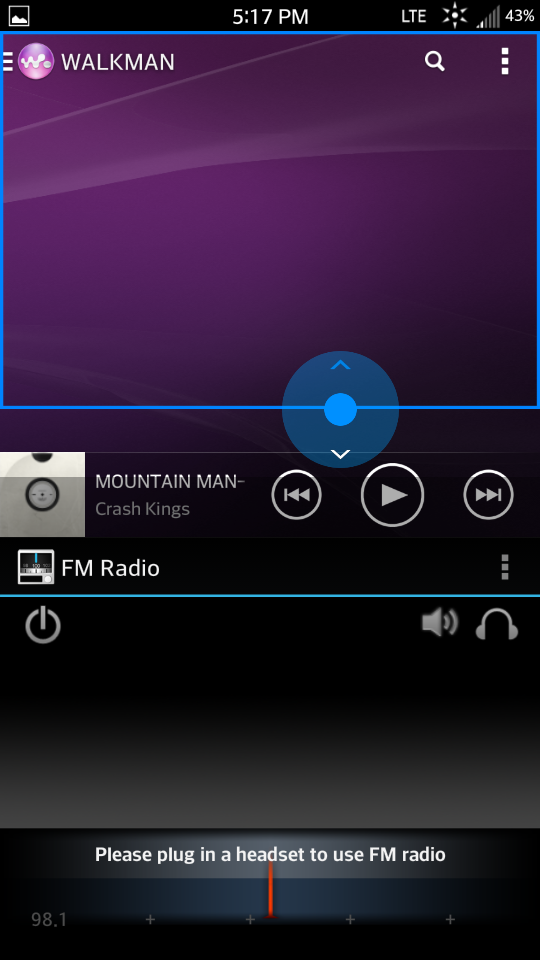

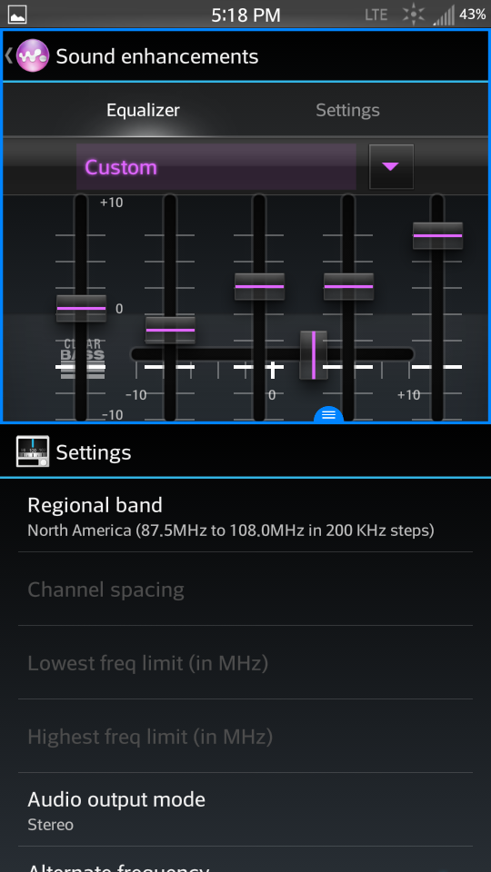

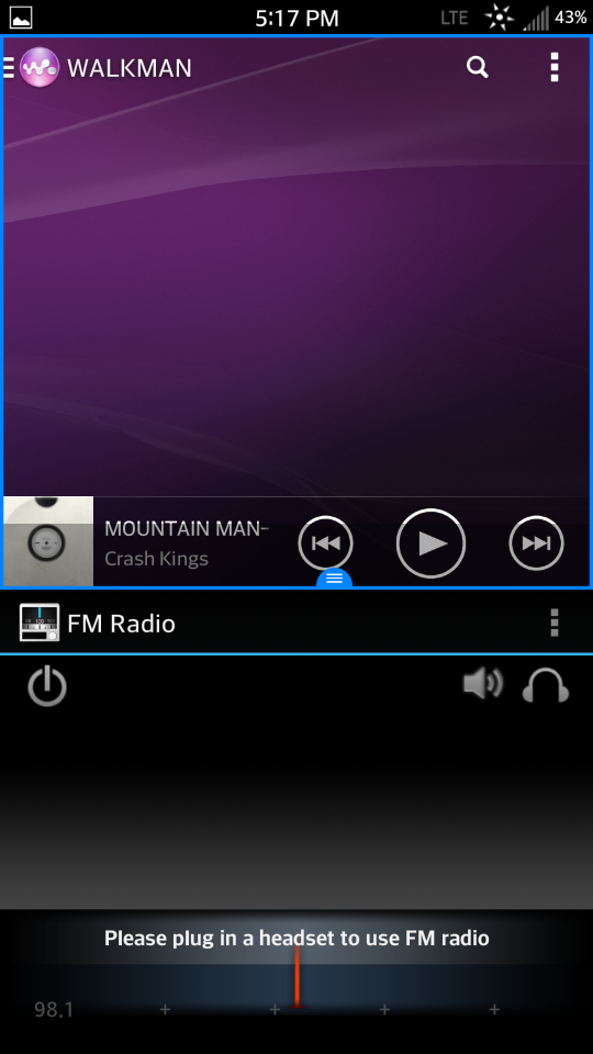

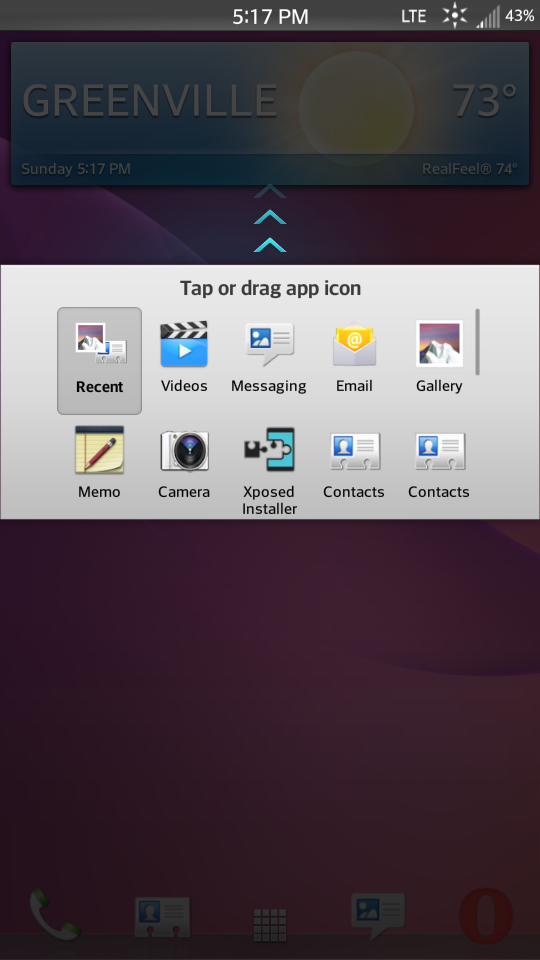

I think I have Split View from LG G3 working on our rom. Want to test everything in as best I can before posting the files to be sure its working good enough to be useful. Heres a screen or two.
Seems to be functional as you can see by the screens. Cant say its 100% bug free though.
Once mod is installed you just long press back button to access the mod.
Screenshot_2015-10-25-17-17-02.png Screenshot_2015-10-25-17-17-41.png Screenshot_2015-10-25-17-17-47.png Screenshot_2015-10-25-17-18-20.png
