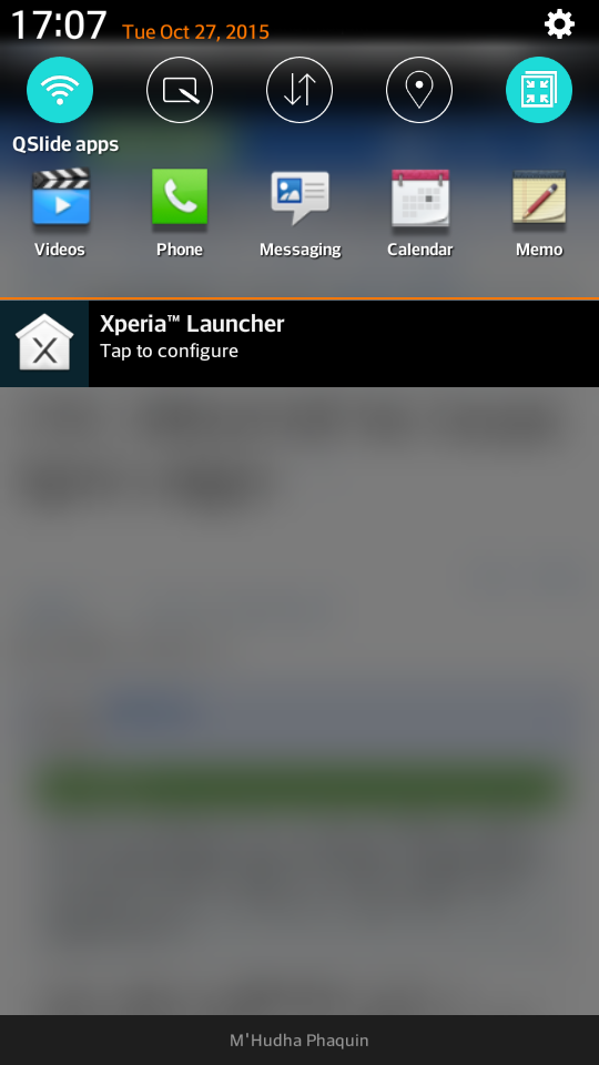

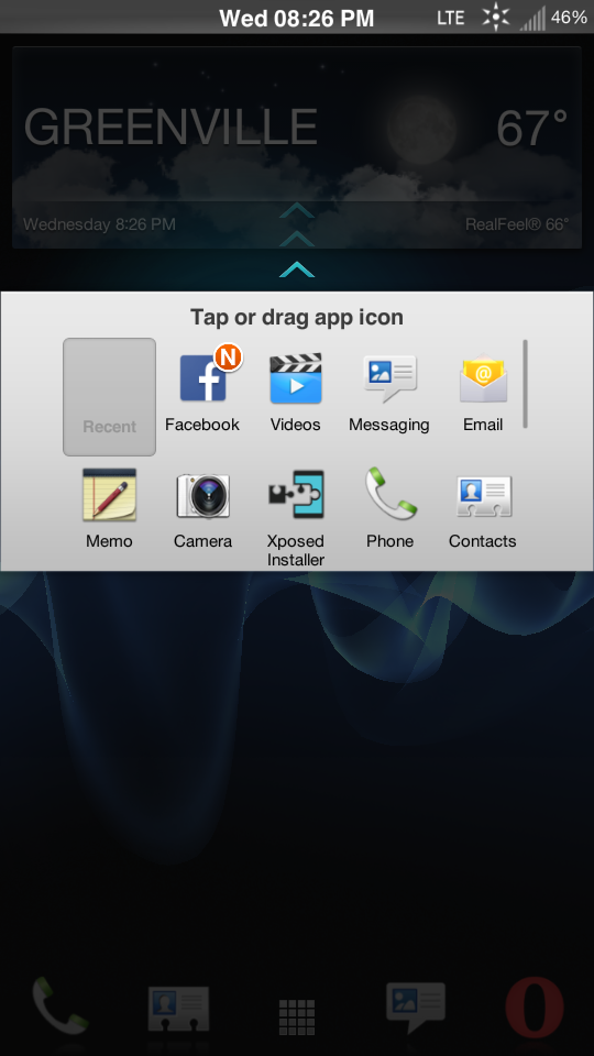

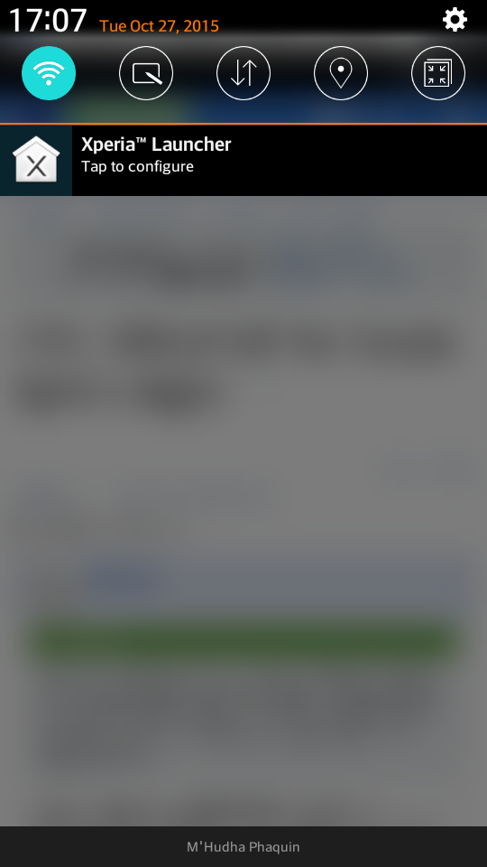

How did you theme the qslide apps in the notification menu? Is there a zip we can flash in recovery we can use? Ive been using G3 Tweakbox but its kind of limited in what I can change, and themes wont work on it. I still have the grey boxes on mine. (I haven't flashed this rom, just using stock right now)

Try g2 tweaksbox

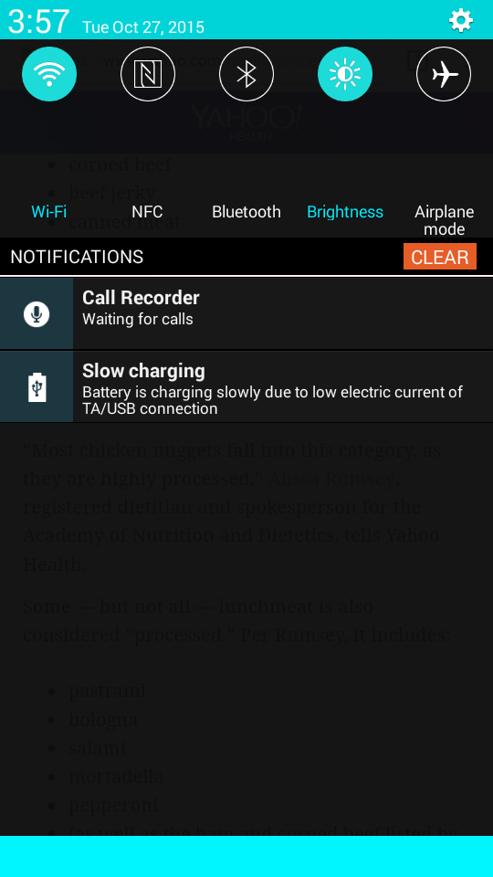

I tried that one as well, but am having trouble with it also changing the tiles. Theres an option to allow the G3 flat UI or something along those lines, but theres a large gap like its stretched out

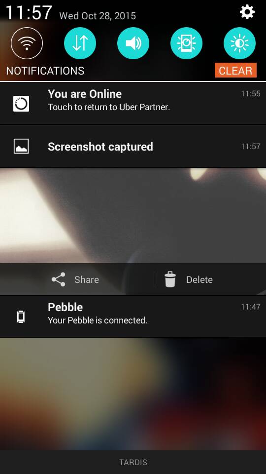

Yeah you can also just keep the stock icons and change the stock colors and transparencies to get a good look. In g2 tweaksbox you can edit notifications panel by changing stock color to one you like with a transparency you like then check mark apply to all others. And in quick settings panel just check mark the top option

What about the buttons? Those aren't stock. o_O
If you download G2 Tweakbox theres an option to enable the LG G3 UI which will change the buttons to the screens youre seeing

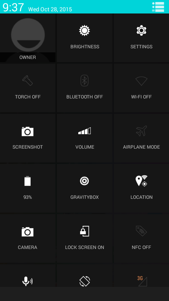

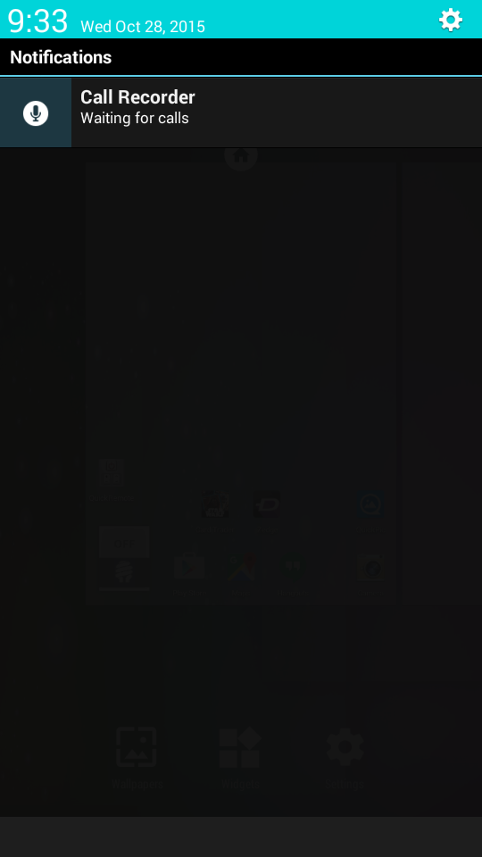

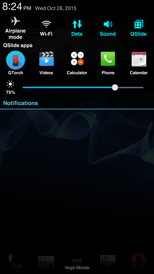

I ended up just removing the qslide menu alltogether since I think I deleted some framework files earlier and it wont let me edit the order anymore. Theres an option in the G2 or G3 Tweaksbox that allows you to use AOSP notification menu tiles by swiping to the side or hitting the menu button which Im liking for now. I miss having a brightness slider in the pulldown menu, but theres also an option to allow brightness sliding across the status bar

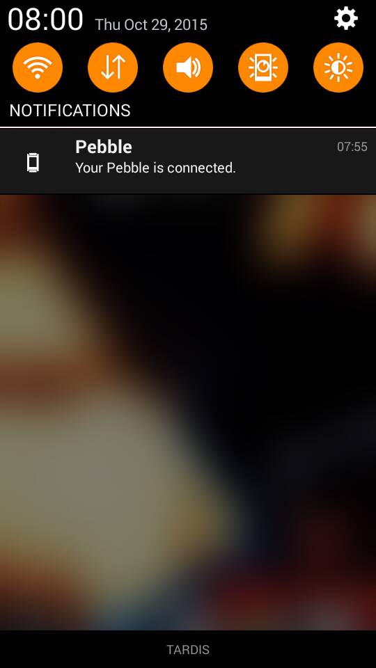

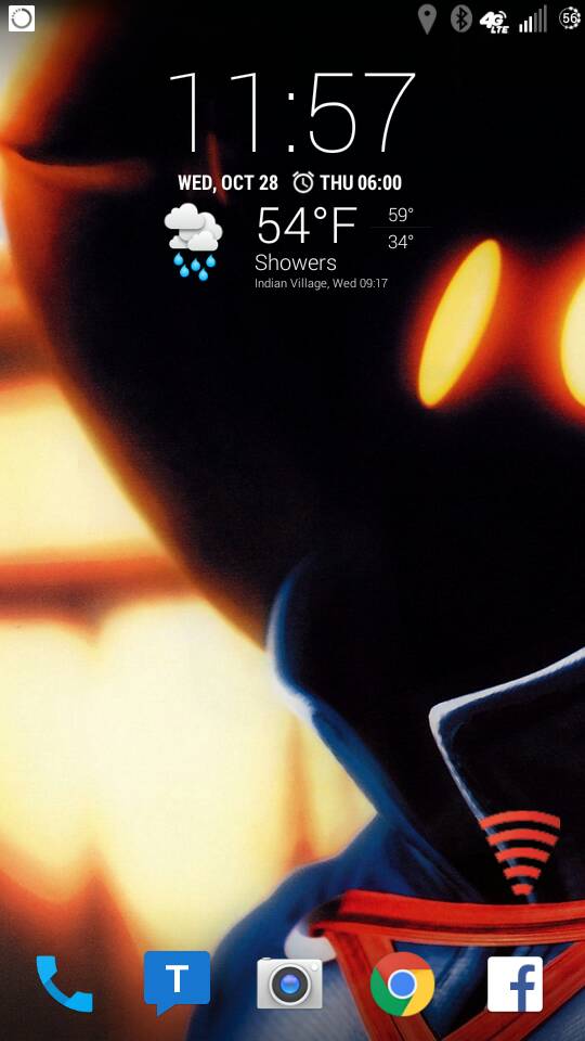

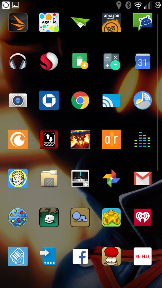

OK, I've about got it... Although, I don't want the Quick Settings background transparent... What do I need to switch to fix that? Also, the button color? Wish there was one module that did everything... Using a combination of G2, G3, and GravityBox. Here's some shots... :)

Just open notifications section of the mod,edit the background color to solid black,transparency about 50%. Tick the checkmark for it to color all the panels. Now the blurred effect you should turn off and youll get what i have or you can go with the g3 style with labels turned off also

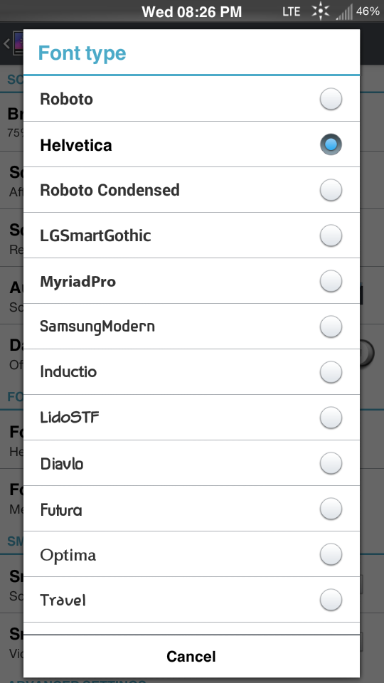

Working on a version three of both rom sets. Heres a screen or two of two additions. Splitview and extra system fonts to select from. These screens are from xperia so no screens of the change up for stock mod which had walkman but now has apollo with dsp manager which can be replaced with other sound engines like viper. I am also doing other things so these wont be up just yet.
Thanks for the tip Curtis, pointed me in the right direction... Just had to make all the notification panel backgrounds black...

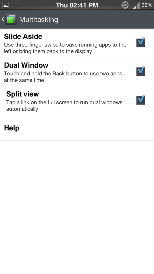

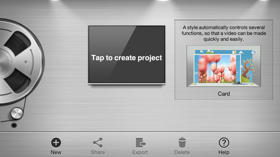

Ok thought I had the g2 launcher working. And I did. But it was operating using the cached settings of our launcher. So in theory you can run it after booting up with our launcher,configuring it the way you want then overwrite its apk with the g2 launcher then reboot. Not very practical. But all is not lost by a long shot. I got full multitasking for splitview and Slide Aside. Multitasking is now selectable in settings. Also got the original fmradio functioning although not tested yet. Functioning means its opening for me without crashing. Plus what might be a very useful video movie maker. Much more stuff to try and get functioning. Heres some screens.
