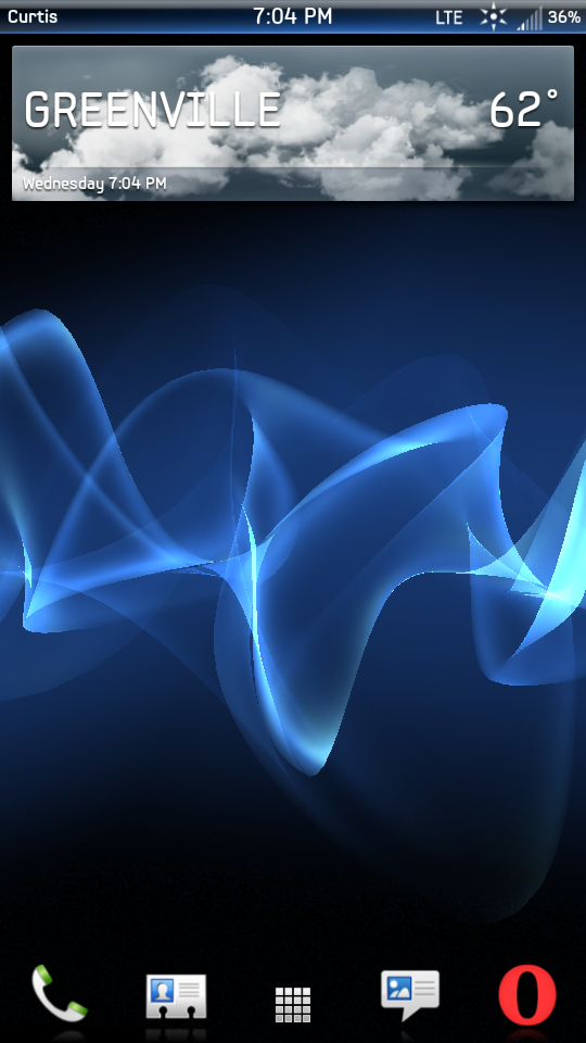

Trying out a few status bar colors etc for the rom set. Not a bad color...not sold on it yet though...
