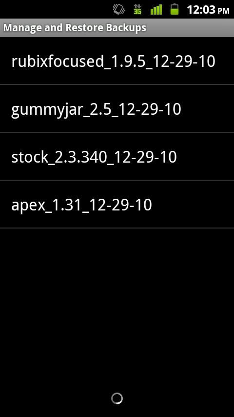

If you create a backup from recovery, it just uses the date/time, which won't mean a thing to you if you have several backups 2 months from now, so I use Rom Manager to backup and give it a meaningful name. Here is what my backups look like:
You can't use spaces in your backup names since you'll end up with a backup you can't restore until you rename it. If you use a colon or semicolon, it'll try to backup, but fail. Don't rely on just one backup for something like stock (that you'll use for the next OTA). I've had a couple backups that don't work for whatever reason.

Not sure if this is a silly question or not, but how did you take a stock "unrooted" backup using Rom Manager since it needs root access?
If you're referring to my backup names, when you make a backup you can't see what names were used before. Since you're always "winging it", my naming isn't 100% consistent.
I suspect both stock backups are rooted, but just one of them has "root" in the name.
If you were rooted, installed recovery, unrooted, then did a battery pull (or some other means of entering recovery), you might be able to backup an unrooted phone. (But that's not what you asked.)

I currently have the following ROMS installed and backups (see attachment).
Now I have to pick one, good luck to me!
