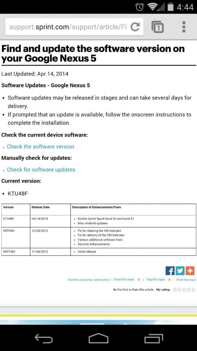

Its likely because of the sprint spark update and signal drop issues
Yes that will work, you could also just flash the firmware/radio bits seperately
there is no radio in this update. he was talking about general updates that sometimes have radio etc.
edit: obviously rxpert responded. i stand corrected.
Its not a sure thing, I'd just expect to see it because of the FCC compliance fix (sprint spark) and the connection dropout fix.
Yeah they are adding in the Sprint Spark update for bands 26 and bands 41.
That's where the "fastboot flash radio" command will come into play.
