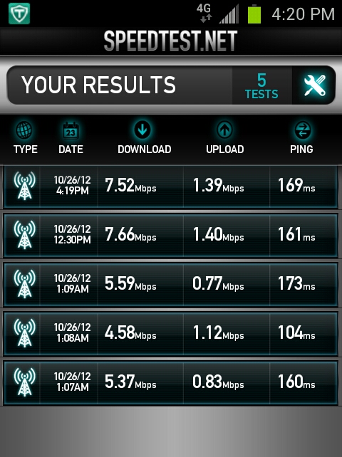

Strangest thing. I was rooted on a CM10 rom and I thought my speeds were low. I was actually getting FASTER speeds on 3g than on 4g. I odin'd back to stock and tested again and I immediately started getting roughly 4-5 times the speed that I was getting just a few minutes before.

I asked over at xda and they said it's an issue with custom kernels. I flashed agat fi27 stock repack and now I'm pulling 10mbps as opposed to 600kbps. Makes me sad that i can't have cm10, aosp or aokp roms if i want 4g speed

I did the same thing and I can also confirm my 4G speeds are back to normal. I am now downloading at speeds of 8-12mb/s:D. Prior to flashing this kernel I was averaging between 1-2mb/s:(.
HOWEVER...since flashing this kernel, some apps will not install on my phone. It gives an error that reads cannot install onto internal storage or sd card. I have unmounted the sd card and remounted. I have also unmounted the sd card, rebooted the phone and remounted and still the problem exists. Now the apps will install on the phone if I unmount the sd card and leave it unmounted. But if I remount the card after installation and try to transfer that app onto the sd card, it will not let me as another error pops up.
