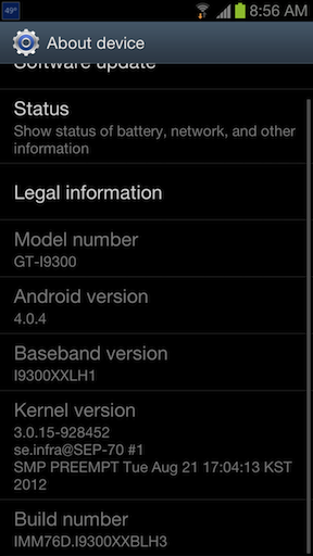

I purchased a new (in sealed box) GS3 about two weeks ago. When it came, the initial setup language was French, so setting it to USA English and setup went as normal. It is running 4.04, and a software update is obviously available.
It will DL the update, then the Android Robot begins his update annimation, when it hits 33%, it crashes / fails. I have tried this update several times and the results are the same.

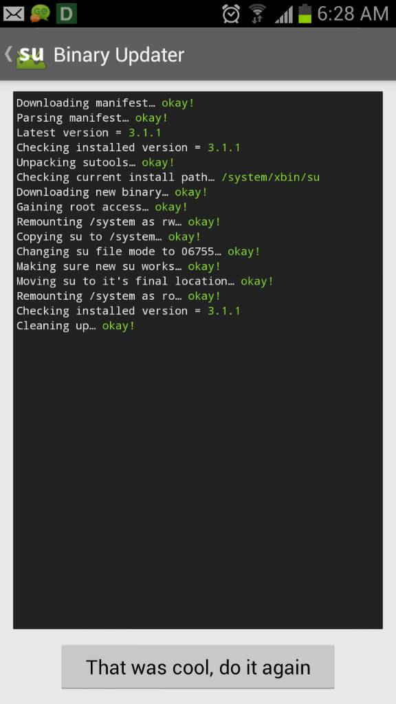

The phone came with the app. I run the check on it and result for root access states "okay"

If I tap to check updates, it runs a system test and "root access" test result reads "okay"

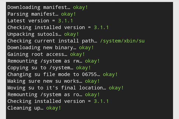

Here is a screen cap of the Superuser test results.
I have no idea what I am talking about, but I suspect the phone is rooted! That being said, is it possible to get an OS beyond 4.04?

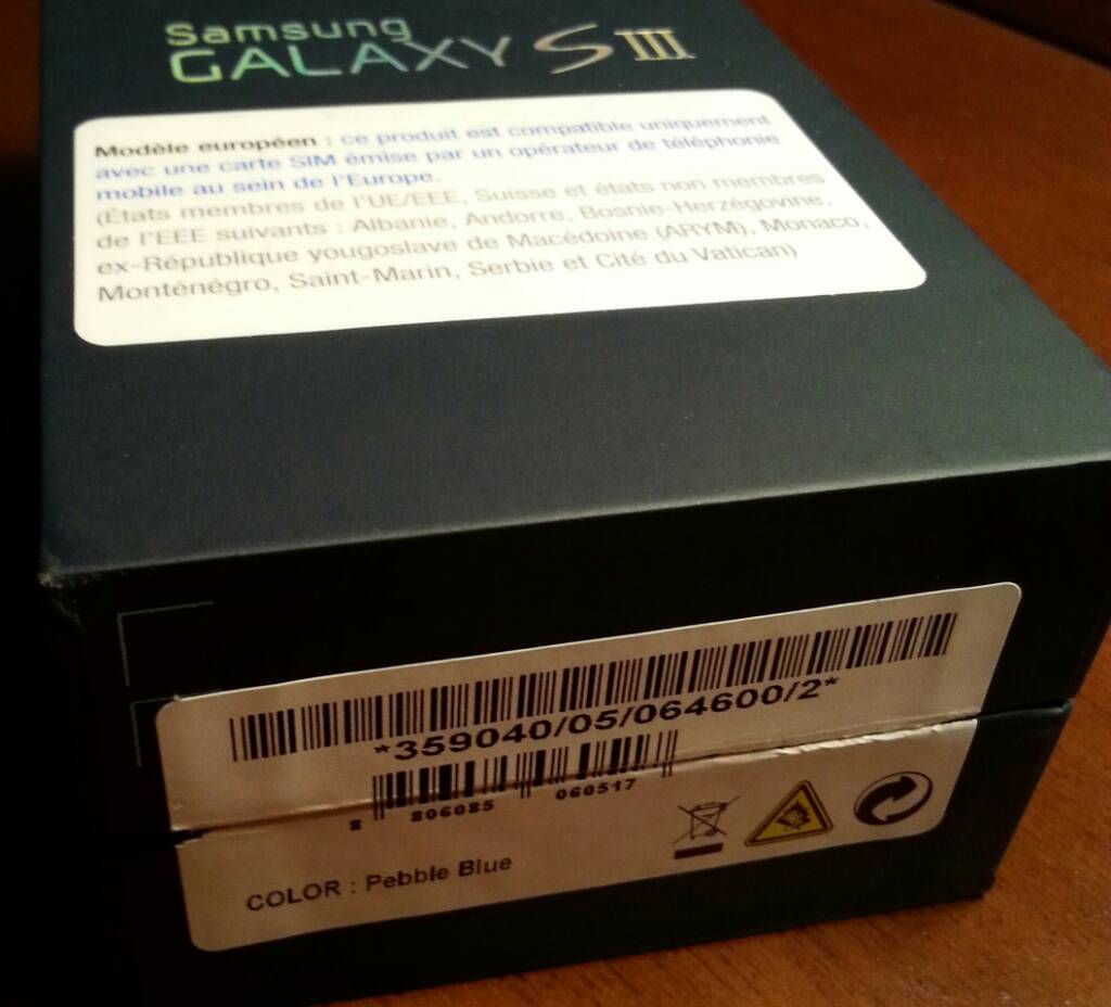

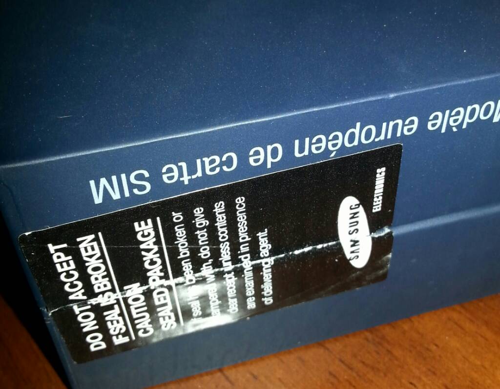

Sorry buddy, I failed to answer you second half of your reply. I bought the phone from Newegg. I was skeptical, but when the phone arrived, I found the Samsung S3 box was pristine, and unmolested MFG tape on both sides of the box (identical to the unboxing videos on youtube). Contents of the box, ie. battery, ear buds, charger, data cable, etc., all packaged tightly. I am very certain that this phone is not used. Very pleased with the purchase!

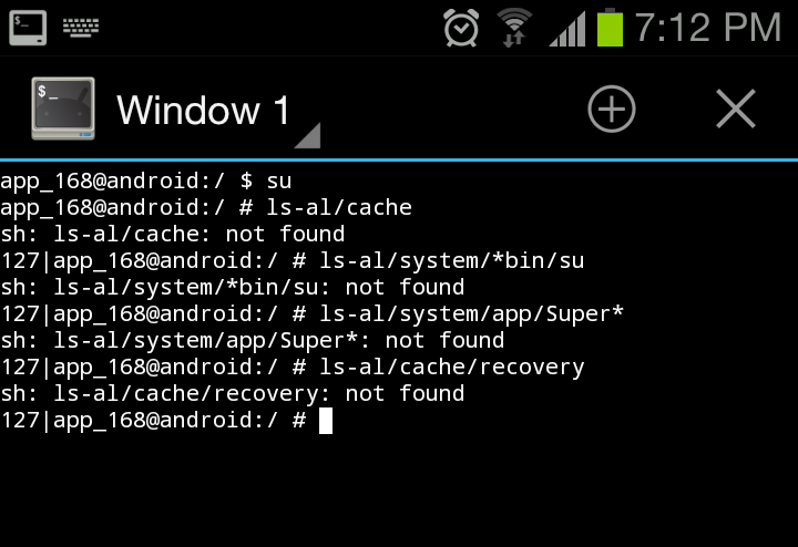

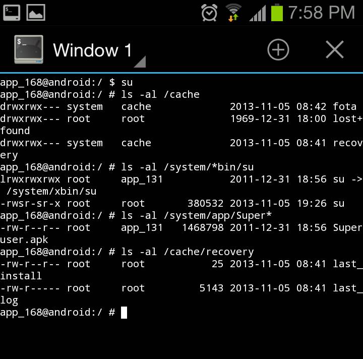

Not sure if I did this correctly, however here is the results (or a lack thereof).
Ah, thanks rexbaum...sorry I didn't tell you that the spaces are meaningful.
Here it is again with the spacing emphasized:
Code:
$ [COLOR="Red"][B]su[/B][/COLOR]
# [COLOR="red"][B]ls  -al  /cache[/B][/COLOR]
# [COLOR="red"][B]ls  -al  /system/*bin/su[/B][/COLOR]
# [COLOR="red"][B]ls  -al  /system/app/Super*[/B][/COLOR]
# [COLOR="red"][B]ls  -al  /cache/recovery[/B][/COLOR]
By the way, that's a lowercase "L" (not a one or a vertical bar) after the "a" in the "-al" portion of the "ls -al".
edit: by the way, your output does indeed confirm you are rooted (note the "#" prompt after you typed the "su" command).
Sitting here with my mouth hanging open! You guys have superhuman powers. I might have done it right this time.....
Thank you very much!

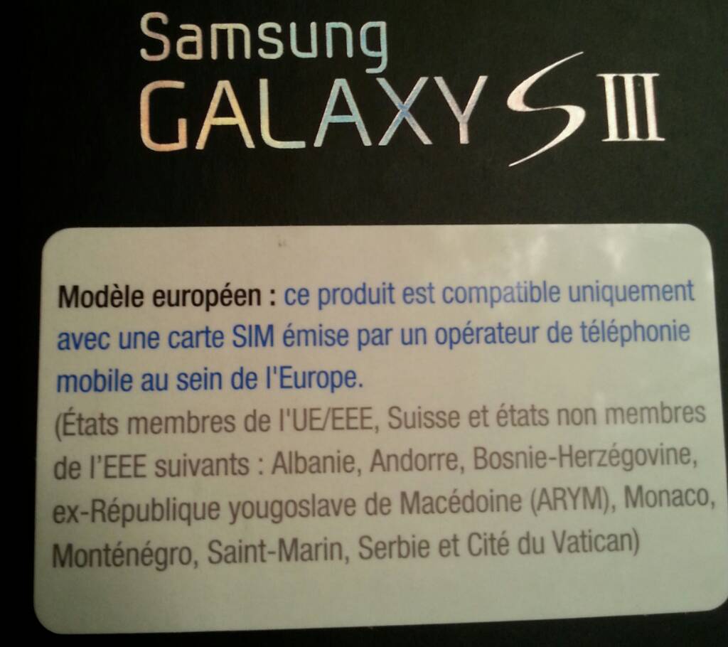

Here is pics of the box. It was sealed!
Being a transformed iPhone user, I have used a couple androids in the past year or so. HTC One X, HTC one and mist recent being the Nexus 4. THIS phone has captures me! I love everything about it!
Can't express my gratitude for your help and being somewhat of a teacher. You ROCK!

No problem, rexbaum--that's what we do here at AF :).
And those pics you posted show a couple things:
1. confirms you are rooted by verifying the su and Superuser.apk binaries existence and security settings
2. shows there is not OTA (over-the-air) .zip file located in your /cache folder (at least currently); however, I'm am curious about the /cache/fota directory (more on this in a second)
3. those pics of your box are pretty wild--someone's got some explaining to do, LOL, if a carrier or manufacturer shipped-out a new device pre-rooted :eek: ;) :)
