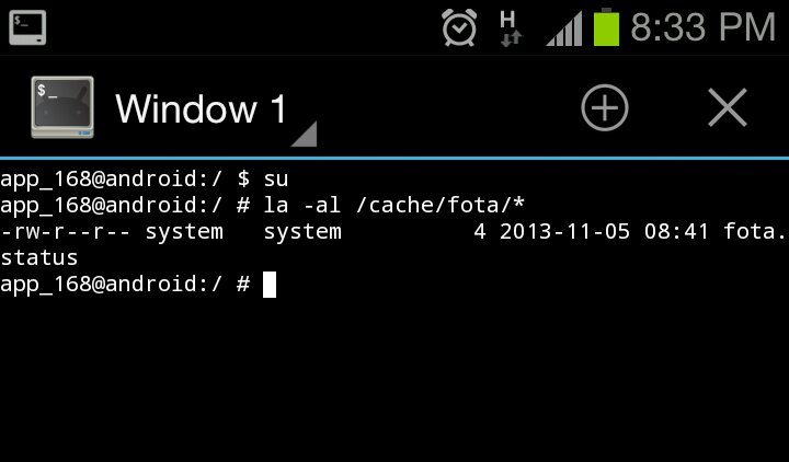

The first part of this is easy, the next steps about copying to my sd card sound intimidating.
Ah, shouldn't be that hard, Rex, we'll help you figure it out :).
LOL, I see you type "la" instead of "ls" and basically got the same output (I had no idea there was an "la" alias pre-packaged in busybox (which you must also have ;)). Anyway, it showed what I needed it to (i.e., that there still is no saved OTA .zip file in your /cache directory where I would have expected it to be had one been downloaded and then failed to install (although it might get removed on install failure? I'm not 100% sure about that).

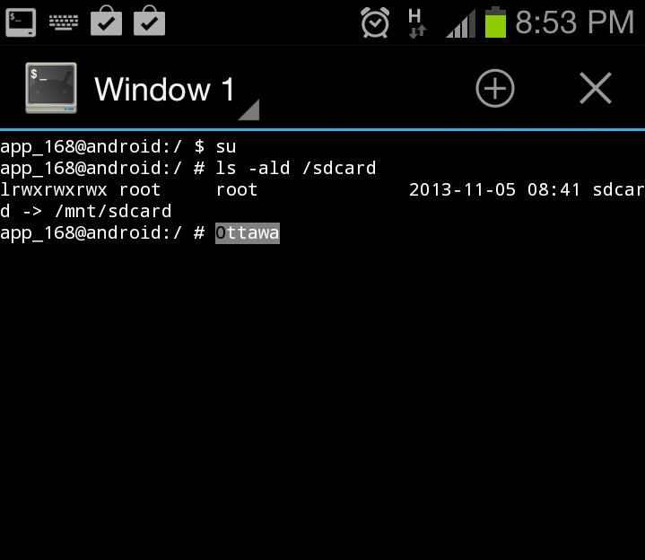

If you do have the "/sdcard" filesystem, which you can verify with this command:
Code:
root@android:/ # [COLOR="Red"][B]ls  -ald  /sdcard[/B][/COLOR]
should show something like this:
[COLOR="Blue"]lrwxrwxrwx root     root              2013-11-01 08:17 sdcard -> /storage/emulated/legacy[/COLOR]
then the cat commands I gave above should work and allow you to get them to us somehow.

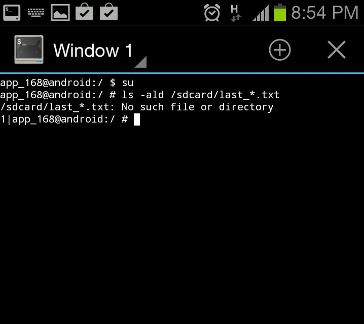

Typing this should show you if you've got the files copied:
Code:
root@android:/ # [COLOR="Red"][B]ls  -ald  /sdcard/last_*.txt[/B][/COLOR]
Have you ever connected your PC to your phone with your USB cable and transferred files over to your PC?
If so, then you should be able to find and copy/paste and/or drag/drop those two files over to your PC and then get them to us (they won't contain any personal info, by the way).
No, you're doing great!
Just need to do these commands to get the files copied (you didn't do them before, right?):
Code:
# [COLOR="red"][B]cat  /cache/recovery/last_log  >  /sdcard/last_log.txt[/B][/COLOR]
# [COLOR="red"][B]cat  /cache/recovery/last_install  >  /sdcard/last_install.txt[/B][/COLOR]
Then you can do the ls -ald /sdcard/last_*.txt command to verify that the files got copied.

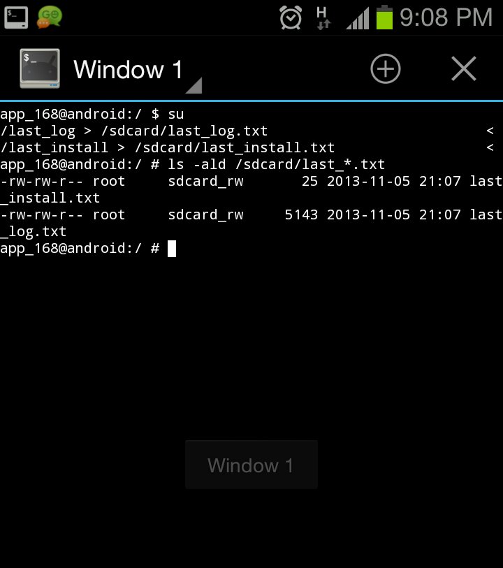

I didn't do those two commands and suspect I have done then incorrectly.... I am not seeing that they told me anything. LOL! You will not hurt might feelings if you get frustrated and tell me to go away! :rolleyes:

You must have done the copies (cat commands) perfectly because that output is indeed what I expected to see.
Now, if you can transfer those files off of your SD card somehow--there are lots of ways to do this:
1. connect phone to a PC via USB cable and drag/drop and/or copy/paste those two files out of the /sdcard folder (will be the proper folder that your PC sees when it connects your phone as a mounted external drive). then you'll be able to attach them to a post here (look at the paper clip icon in the post tools for Manage Attachments)
2. send the files from your phone to your Gmail account via the Gmail app and then copy them from your PC's Gmail client and post them here or if you want, email to me (scary.alien@gmail.com) and I'll post them for you
3. use a browser on your phone and sign-in to AndroidForums.com just like I assume you are doing now from a PC and attach those two files to a post
Couple of other ways, too, but the first is probably easiest...

That was/is perfect and indeed shows the issue! :thumbup:
As I suspected, you've got a some component of your device (file or partition) that the OTA's update.zip file (which contains an edify script named updater-script) is cross-checking to make sure everything matches that it would expect to before it would allow the OTA to patch and update your Android OS to a new version:
[HIGH]contents of partition "/dev/block/mmcblk0p7" didn't match EMMC:/dev/block/mmcblk0p7:12583168:90aedf493ac005492e6a69e943252eb755211fe0:12583168:78960cc7f04326c3f336521062586d2171327173
file "EMMC:/dev/block/mmcblk0p7:12583168:90aedf493ac005492e6a69e943252eb755211fe0:12583168:78960cc7f04326c3f336521062586d2171327173" doesn't have any of expected sha1 sums; checking cache
failed to stat "/cache/saved.file": No such file or directory
failed to load cache file
script aborted: assert failed: apply_patch_check("EMMC:/dev/block/mmcblk0p7:12583168:90aedf493ac005492e6a69e943252eb755211fe0:12583168:78960cc7f04326c3f336521062586d2171327173", "78960cc7f04326c3f336521062586d2171327173", "90aedf493ac005492e6a69e943252eb755211fe0")
E :Error in /cache/fota/update.zip[/HIGH]
(i.e., the SHA1 checksum of the partition doesn't match what the OTA expects it to; this is a safety measure to make sure it doesn't try to patch and improperly alter your device and have you end-up with a paperweight).
So, it looks like your "/modem" partition (/dev/block/mmcblk0p7) has been altered/modified somehow... I'm not sure why or how that would be the case or someone would want to do that (I don't own an S3, so I'm not familiar with that partitions exact use), but it gets us a little closer to help you out.

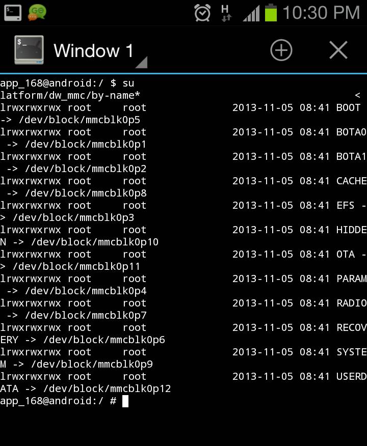

Ah, just found a reference to "mmcblk0p7" as being the radio, which implies that a different radio got flashed.
Rex, when you get time, can you type another command for me, please?:
Code:
# [COLOR="Red"][B]ls -al /dev/block/platform/dw_mmc/by-name[/B][/COLOR]
This should verify that the /modem partition is the same as the radio (I'm expecting to see an entry that shows "RADIO -> /dev/block/mmcblk0p7").
Thanks!
