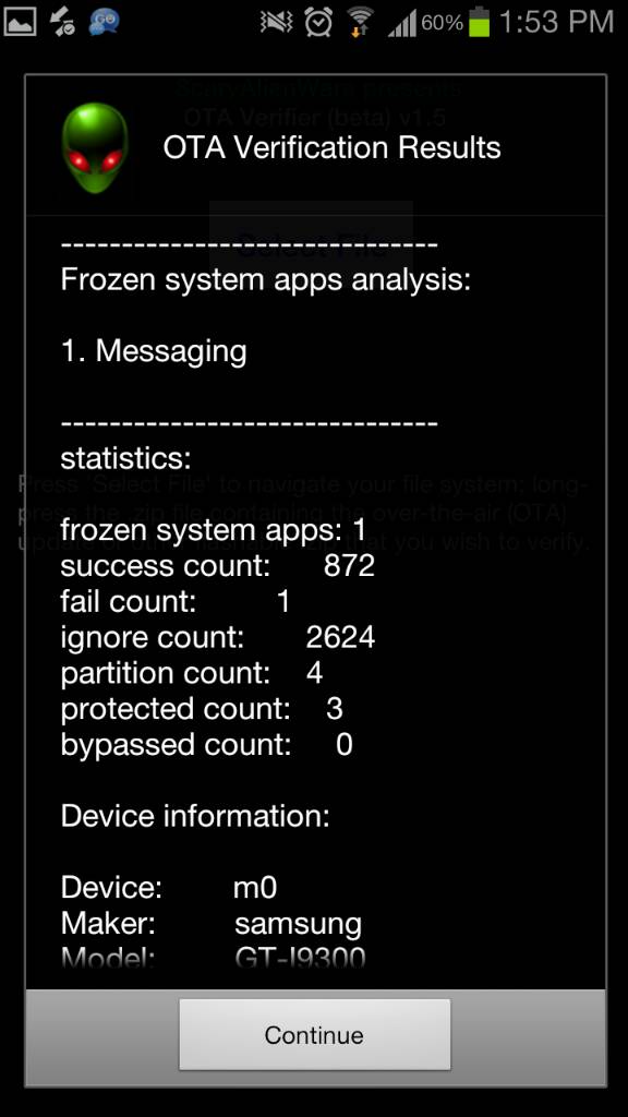

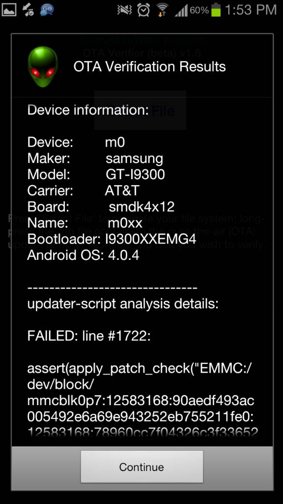

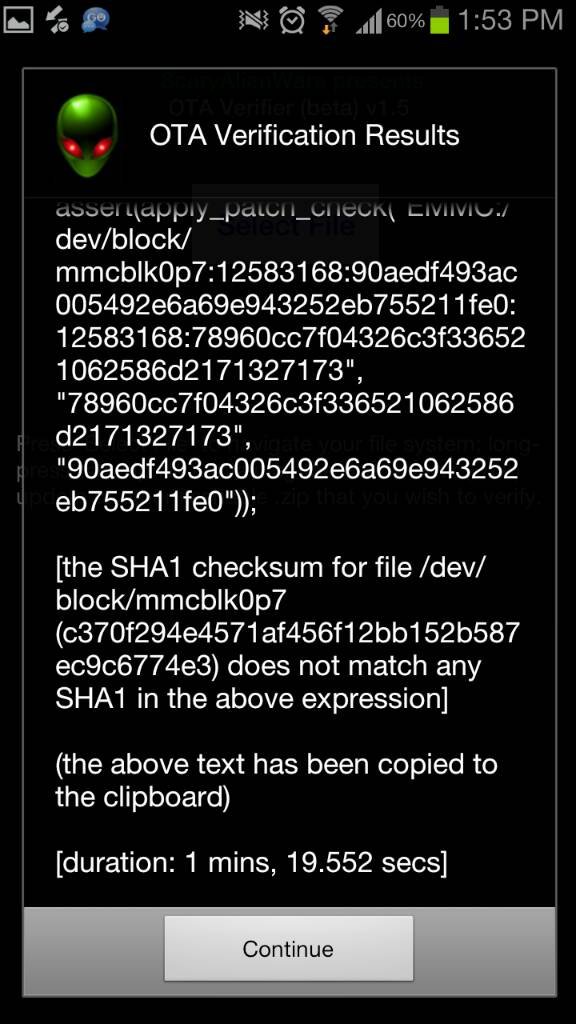

Here you go scary genius!

Eureka! :party:
That's the ticket and the answer I was looking for! :thumbup:
I only see one failed expression which should match the expression we saw/found in the /cache/recovery/last_install.log file (or whatever that name was :p).
I'll verify that in a bit, but it means that the radio is probably the only thing that got flashed / changed on your device (good news on the count of things to deal with).
I just need to look at the updater-script file you sent me (thank you for that!) and verify / see if/that the update.zip would be trying to flash a new radio (i.e., versus patching it).
If that's the case, we can either build you a new update.zip and have you flash it via a custom recovery or figure-out how to flash your radio back to what the current update.zip file expects.
The only issue here is that I'm not experienced with the S3, so I don't have any hands-on experience in installing a custom ROM or flashing a new radio for your device, so we'll have to find someone (maybe our good friend funkylogic? :)) that will be able to help guide us.
Anyway, lemme check a few more things out and get back to you!
Great job, Rex! :)

2. The information from the last_log file you extracted for us from the /cache/recovery directory shows that the OTA is failing a verification (apply_patch_check) on the mmcblk0p7 (radio/modem/baseband) partition. The problem with this is that I found the radio software that your "About phone" reports (I9300XXLH1) and calculated the SHA1 sum of that file and it matches one of the values that the apply_patch_check command is looking for (90aedf493ac005492e6a69e943252eb755211fe0).
In other words, the OTA installation should not be failing, but obviously is.
3. Another piece of the puzzle was/is revealed in the output from my OTA Verifier app that Rex kindly produced that shows the SHA1 checksum of the /dev/block/mmcblk0p7 partition has a value that does not match either of the two values from the apply_patch_check's command. This is the reason for the OTA's installation failure. But it does not explain why it is different or how it became different.
In other words, Rex's "About phone" reports having the I9300XXLH1 radio (baseband) installed, but the SHA1 checksum does not confirm / bear this out.
4. I believe that we can try to identify what radio software is actually installed on Rex's device by a few commands that I still need to put together and have Rex test. I'll need a little bit more time to do this and it's getting a bit late.
Ultimately, I believe we should be able to "fix" (re-flash) the I9300XXLH1 radio, but that is something that is typically done on a quiesced system--i.e., booted in custom recovery--but installing that would make the OTA file in validating the mmcblk0p6 (recovery) partition unless / until we flash it back after re-flashing the radio. Ugh--snake eating its tail :p.

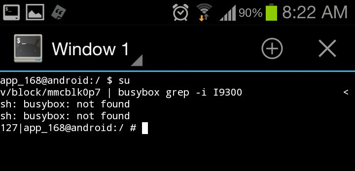

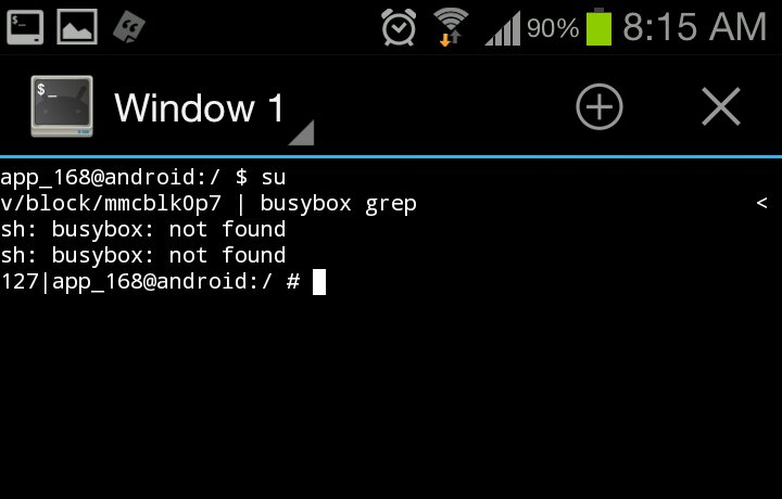

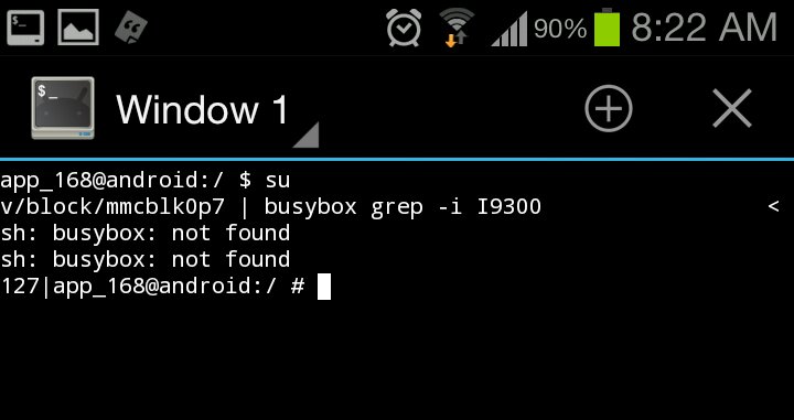

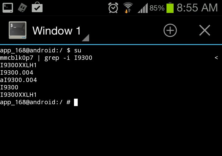

Okay, if you can pull-up your Android Terminal Emulator again and type this command:
Code:
$ [COLOR="Blue"]su[/COLOR]
# [COLOR="blue"][B]strings  /dev/block/mmcblk0p7  |  grep  -i  I9300[/B][/COLOR]
that should work if your busybox utility has its links setup properly. If not, try this instead:
Code:
# [COLOR="blue"][B]busybox  strings  /dev/block/mmcblk0p7  |   busybox grep  -i  I9300[/B][/COLOR]
and then paste the output back here (screen shot like you've kindly done before).
This should dump the version information of the radio that you currently have installed.
After we get that, I'd like to find the radio and download it to verify that the SHA1 checksum for that radio matches what my OTA Verifier app is reporting it's finding on your S3.
Thanks!
Ah, no worries, Rex :).
You can get it from here: https://play.google.com/store/apps/details?id=stericson.busybox
After you download and install the app, open it and click the Install button.
The busybox is simply an all-in-one utility that packages a bunch of very helpful Unix / Linux commands / utilities in one executable (called the busybox).
It also sets-up symbolic links for those various commands and they all point to the busybox which allows commands like strings and grep to be used and strung together to do something useful like grabbing the displayable ASCII strings (via the strings command) from your radio software and find (via the grep command) the version information.
After you install the busybox, try running commands again and see what you get.

LOL and that's a little unexpected :confused: (although at some level its good that it reports what your "About phone" shows).
That is indeed the same output I get when I scan the downloaded XXLH1 radio binary from the site I linked to before:
Scary Alien@LV-426 ~/rex
$ strings modem.bin | grep I9300
I9300XXLH1
I9300.004
aI9300.004
I9300
I9300XXLH1
Hmm, not exactly sure what that means at this point...
So, either your radio partition is corrupted somehow but your actual radio is working just fine.
The difference could be a single bit off to cause a difference in the SHA1 checksums.
At any rate, we're probably still at the same place as we would have arrived anyway which is to decide if we should re-flash your radio (and at least we know that your device thinks you do and should have the XXLH1 radio) which requires installing a custom recovery --or-- modify the OTA's update.zip file to ignore the checks for the radio verification (which sounds a bit iffy to me--I don't necessarily like that idea) but which also requires installing a custom recovery.
As I indicated before, I'm not an S3 rooting expert, so I can't necessarily advise you or guide you through installing a custom recovery so you could re-flash the XXLh1 radio (which can also be done via the Odin utility which I've never used (never had to)).
Then, we'd need to verify that your re-flashed radio passes the SHA1 check via OTA Verifier (you wouldn't be able to retry the OTA installation because it will poop-out because you've changed the stock recovery to a custom recovery (catch-22)).
After verifying that your radio finally reports the proper SHA1 checksum, we'd get your stock recovery re-flashed and then let you install the OTA so you can get JellyBean (4.1.1).

I'm jumping in this thread late but why don't you flash the newest modem or just flash a rom?
Rex's original goal was to figure-out how to get the JB 4.1.1 OTA to install on his device. For all intents and purposes, it should be installing (as far as I can tell at this point).
I think that's where we maybe were heading, but I think Rex would need to be aware of the process and consequences and precautions to take ahead of time (i.e., backups, etc.).
I'm hopeful that re-flashing the XXLH1 radio would get him past the OTA installation issue.
Do you have a list of flashable radios mike mate?
https://www.wuala.com/UpInTheAir/SGS3/Modems/I9300/ICS/CWM?key=n0KVwtIMZPE8
courtesy of this thread over on XDA:
xda-developers - View Single Post - [REF] Galaxy S3 Modem / Radio Collection (I9300 & I9300T ONLY) CWM & Odin Flashable
(double-check me, guys, since you're the S3 experts and not me).
