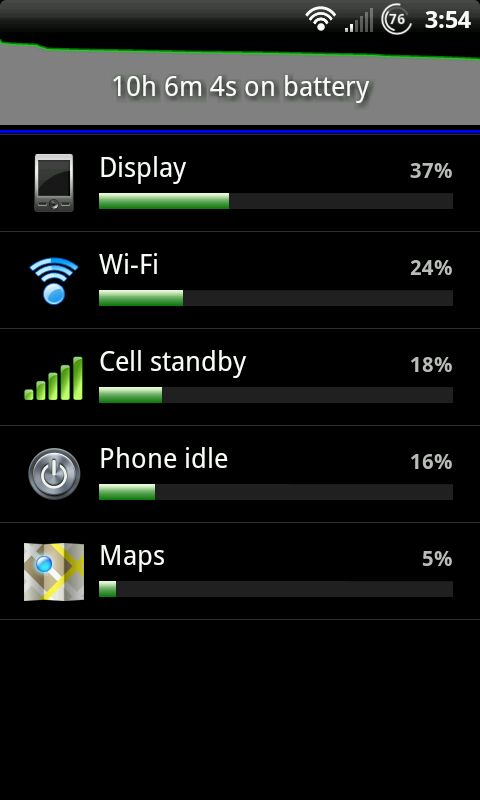

The 4g will add to battery drain and if its on and you dont have a 4g sig it will realy drain it. Mikg2.60 is awsome with the battery life.
I would recomend this rom as a first flash and its my daily.
I use it as mik has it set up no set cpu and stock kernel.
Tahe a look at my battery today so far with average use for me,
I'm checking mine now after the phone has been "on" but not charged for 36 hours or so.

36 hours is awesome battery time for our phones, its working properly. ;)
To find your battery info go to Menu / settings / about phone (very bottom) / battery click around in this menu there's a few screens you can check out that will show what has been using the battery.

Following your instructions i get to a screen that looks a little different than screen than the one posted. It seems similar but different. Is there a way that i can take a screen shot ot the battery use and upload it here?
Mine says: 19h 51m25s on battery. The battery indicator looks completely full green:
wifi 19%
Android System 20%
Dialer 20%
Call standby 17%
Phone idel 16%
Display 6%
Maps 2%
The 36 Hr's is great but when that 4G was checked the battery lasted about 8 hours.
And i still think the reason the guy i got the phone from told me not to use 4G is because it just doesn't seem to work at all in that i can not make a phone call when 4G is checked unless i'm in a wifi zone ( like home ) when i leave wifi checked as you can see in the above battery use break down.
