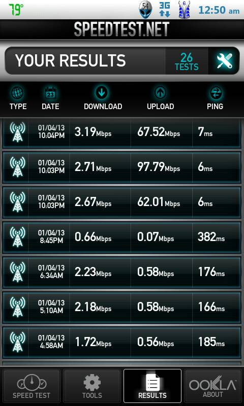

Wow- changed DSS proxy, MM proxies and switched Vocoders to 4VG. Jumped from 190ish kbps DL and 100kbps UL to 909kbps DL and 190kbps UL!!!
It's like crystal meth for your phone.
So you mean eventually this phones teeth will rot out and it will have dentures.. lol
Try using the 56009.prl from sprint..its a corp prl,my speed jumped a lot
Then again i guess it might depend on ur location.most of the time i only get around .50 mbps where i live..
Dropbox to 56009.prl >>>> http://db.tt/GQZ02p4r
Am I missiing something? I have set the both url for dss to 0.0.0.0., change to 4gv for all 3, and I am using 56009, tried 61085, etc... but the most i get is 150 kbs. Any suggestions
