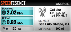

Test results
Wow- changed DSS proxy, MM proxies and switched Vocoders to 4VG. Jumped from 190ish kbps DL and 100kbps UL to 909kbps DL and 190kbps UL!!!
