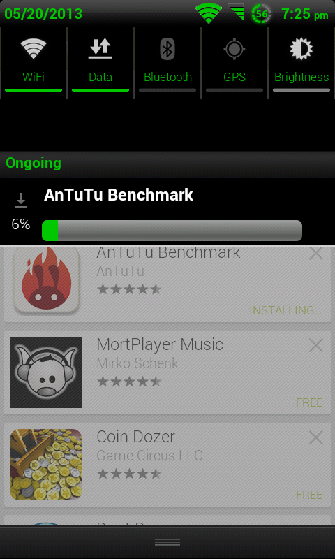

I'm having a weird problem with Titanium Backup. I had the app installed since after I first flashed back to this rom (not a restored backup) about a month ago, then at one point I uninstalled it. Now I'm trying to re-install again but every time I try I get an insufficient storage available error. The app downloads completely, but stops with the error during installation. What makes it weird is that I've got 600+ mb free on my SD card, and almost 2GB free internally. I can download and install any other app without a problem, even one that's over 100mb. Anybody experience this weirdness or know how to fix it?
also: I've already tried a different (blank) SD card, and wiped cache and dalvik, but the problem remains.

That's a new one for me. I'll fire up the old warp and try to duplicate the error.

Thanks. I've tried re-installing 8 times now and I get that insufficient space error every time. How can I make the apk flashable from recovery? Worth a try.
That would do the job, but may not be necessary. Wipe cahce and dalvik cache, and that should take care of it. If it doesn't, you could insert the apk into the /data/app folder of droidsmith. That would install it for sure. The last option is a bit of a gamble, but should also work. Dig through the meta folder of the DS zip, and find the updater-script. Remove the lines regarding formating the system and data partitions, and extracting boot.img. Then you will need to remove the boot.img and system folder from the zip. Once that's done delete all the apks from the data/app folder and replace them with you apk. Then flash it. The options I've listed go in order from good idea to "Thank god I made a nandroid first"
