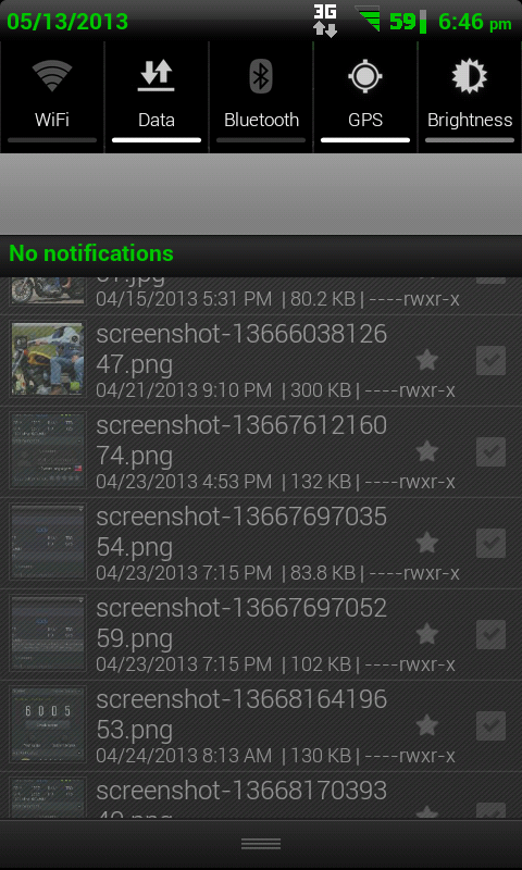

My next goal is either toggles or CPU control in the settings menu similar to cyanogenmod. Once I have both integrated I will be a lot more felixble with the apps that are in the rom, and may make some zips to swap out system apps.
As always, feel free to reference Warp OEM's settings app for those features if you want :-)
