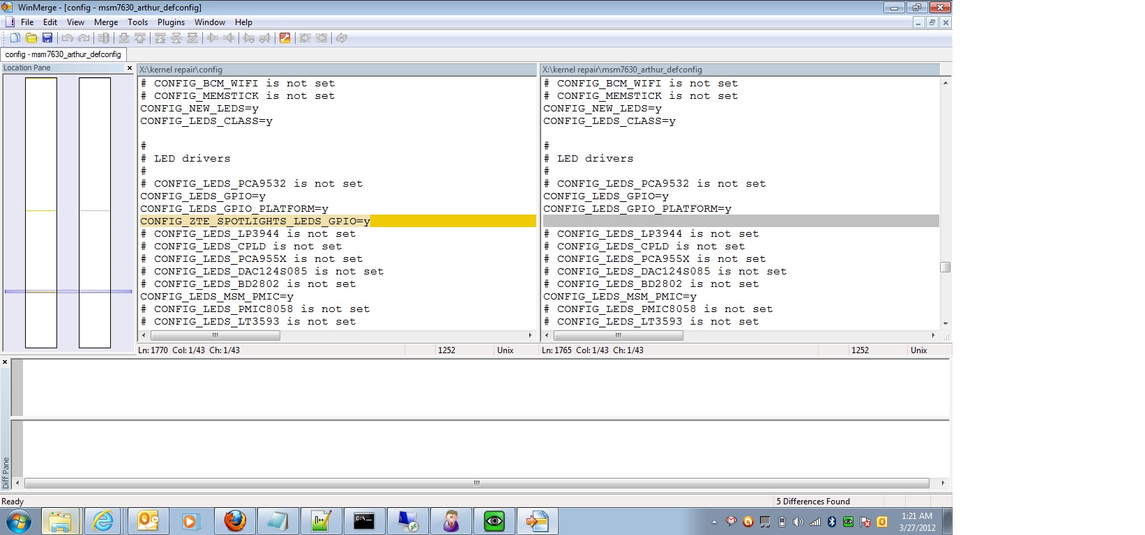

comparing the kernel config that is on my phone to the one that is in the kernel source code I do see this
Now is the source config the one on the right? I I'll pull it up with winmerge and my config from the phone
kernel source config is
arch/arm/configs/msm7630_arthur_defconfig
I have built the source kernel, but it doe not boot
an the there is a slight size difference between the compiled zImage and and the stock zImage
There is quite a few lines then, I wonder why it's listed as msm7630 when the processor is supposed to be msm8655
