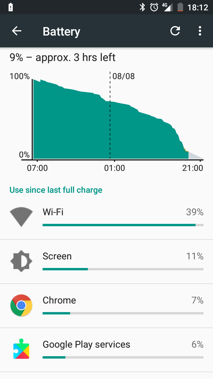

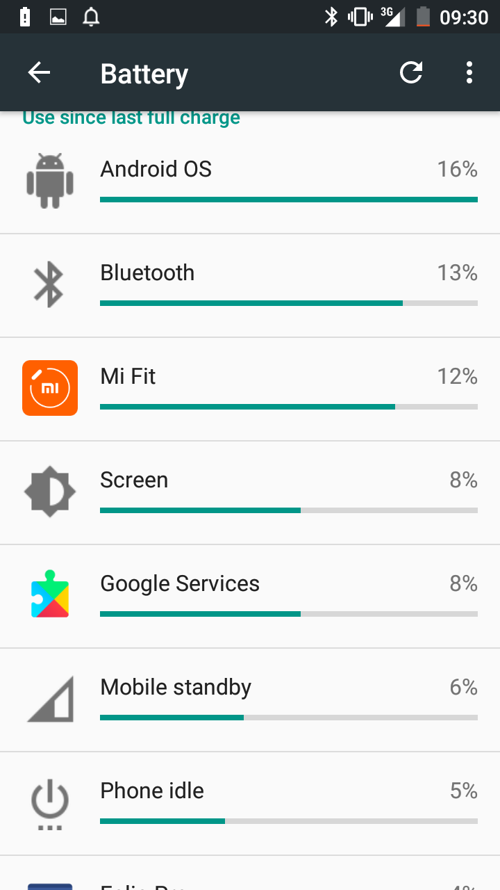

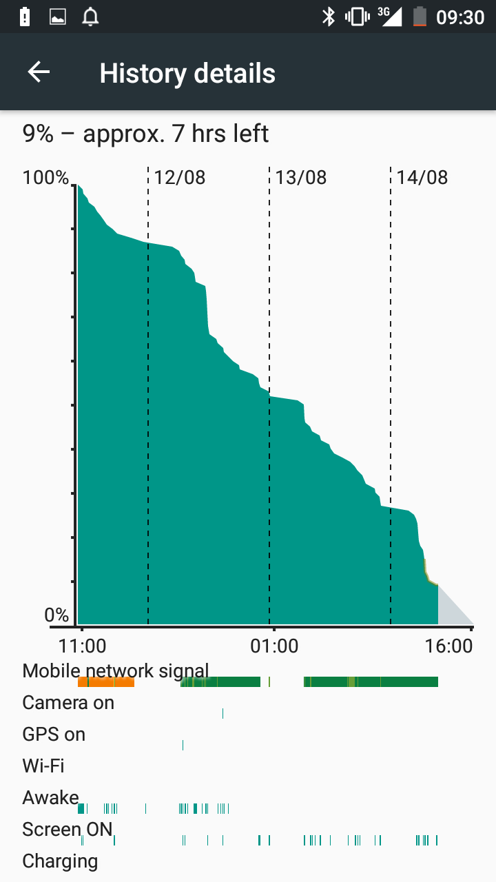

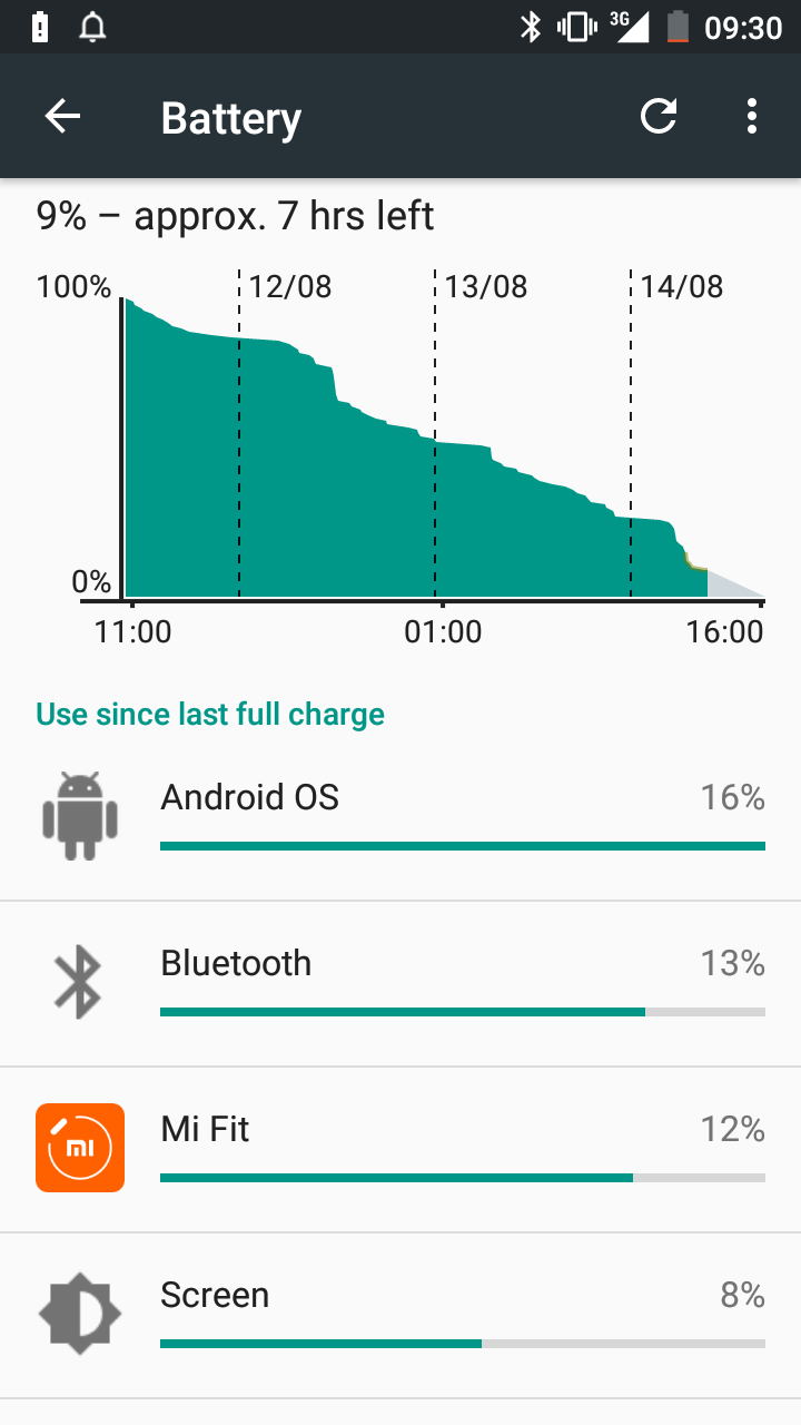

Some battery comparisons.
First image was a day I was having big trouble with the wifi drain problem.
The rest of the images shows what is possible when it doesn't happen (for whatever reason).
