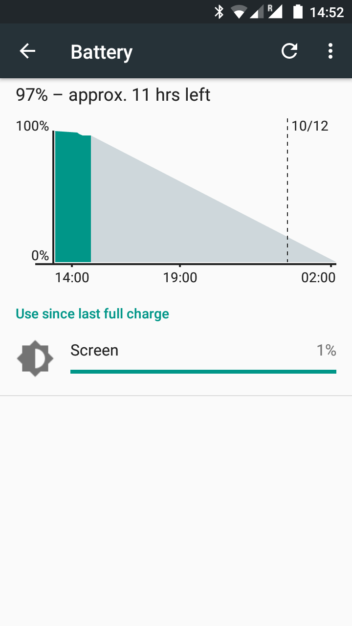

Well I pressed the button...its just updated to the latest version of the Marshmallow software...lets see if the FLIR Camera strobes this time. Fingers crossed it doesn't!
So...I'v been really careful and selected what can and can't access my location and Wifi. I have downloaded all my apps, paired my LG Watch R. Done all the updates for my phone and cleared the caches. Just checked my phone...considering its fresh out the box and has only had one charge (I'm assuming that after a few charges it will work out that my phone will last longer)
Looks like I might be on to a winner ;)
That's appalling

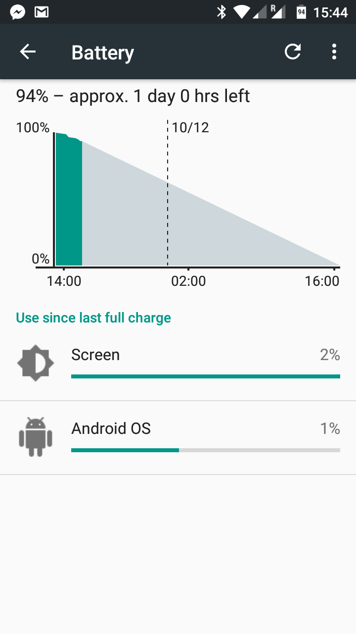

That'll be because its first charge....and hasn't got enough Data to calculate how long it will actually last...it generally takes a few days for it to do the math and work it out accurately...as you can see from the last screenshot the picture/estimation has changed already ;)
