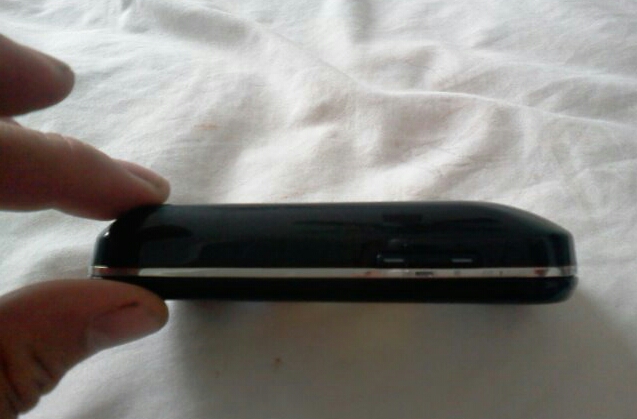

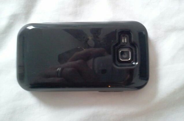

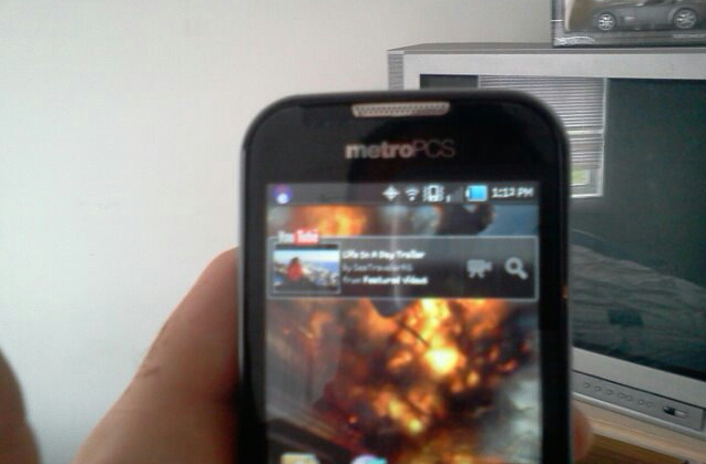

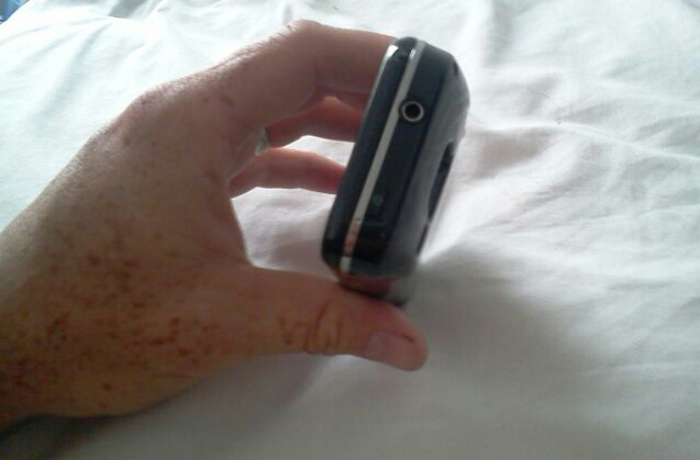

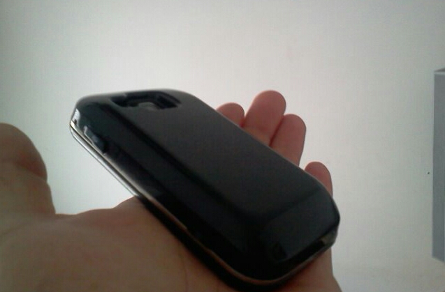

Ok, I had some spare time so I thought I would take some photos of what the ebay extended battery and new back actually looks like on the phone.
