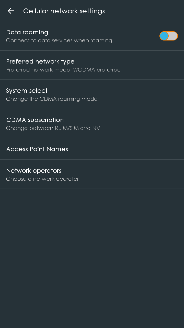

In CM13 I see 2G and 3G options but the changes don't stick, if I go to that advanced menu where more network types are listed none of those stick...the same happens in BrokenOS. So no...you're not alone ///
*the two screenshots are from BrokenOS where (in my case) the problem still exists, it won't stick to any Network Type
If you put the correct apn settings in you will see the 4g LTE option. If not you will only see 2 and 3g. I'm almost certain that's your problem. No need to flash modems etc. Just use the correct apn
