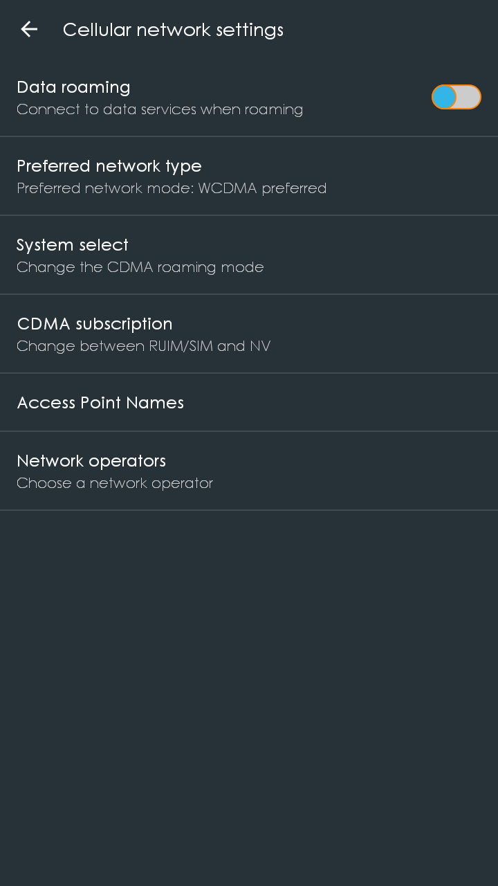

The APN settings are correct, on stock ROM they work and I've set everything just like on stock and nothing changes. Can't select different network prefs, they just won't stick...

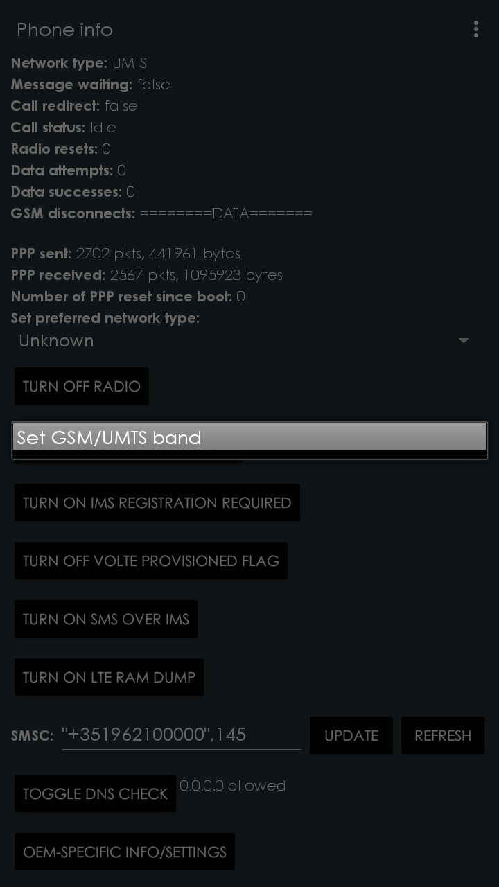

Yes, I did clean-flash several times...Also in the advanced Network settings menu, I can't select other radio bands. I'm not sure wether it can be related to the kis3ril.zip file I've once flashed along with other Roms or not.

Let me know if you can change the radio band (press menu key to get to that option) also I could use a little help on getting this thing to show/stick to 4G/LTE because it only sticks to "WCDMA Preferred" I've wiped everything today and flashed butternoob rom just to check and it shows and sticks to 4G and other Network prefs, but as soon as I flash BrokenOS or CM13 all I can get is that "WCDMA Preferred"

Mine says lte/gsm auto (prl) . . Under network type says Lte and radio band is set to automatic also i installed broken 4.7 and banks dynamic gapps and the problem was gone just a fyi g/l
No matter what I do I can't choose a different network preference...just flashed Metro 4.4.4 stock, and 4G worked, tried dirty flash of BrokenOS/CM13 and the problem persists, tried clean flash and the same thing...can't figure this out... also the radio band is set to GSM/UMTS and I can't choose a different one @hroark13 @Masterchief87 anyone, can you please upload your Ril as a flash able .zip file so I can test it to see if it solves my problem?
