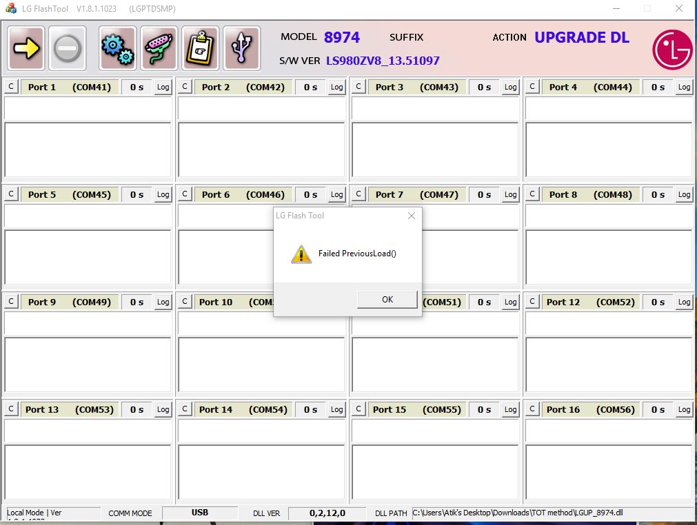

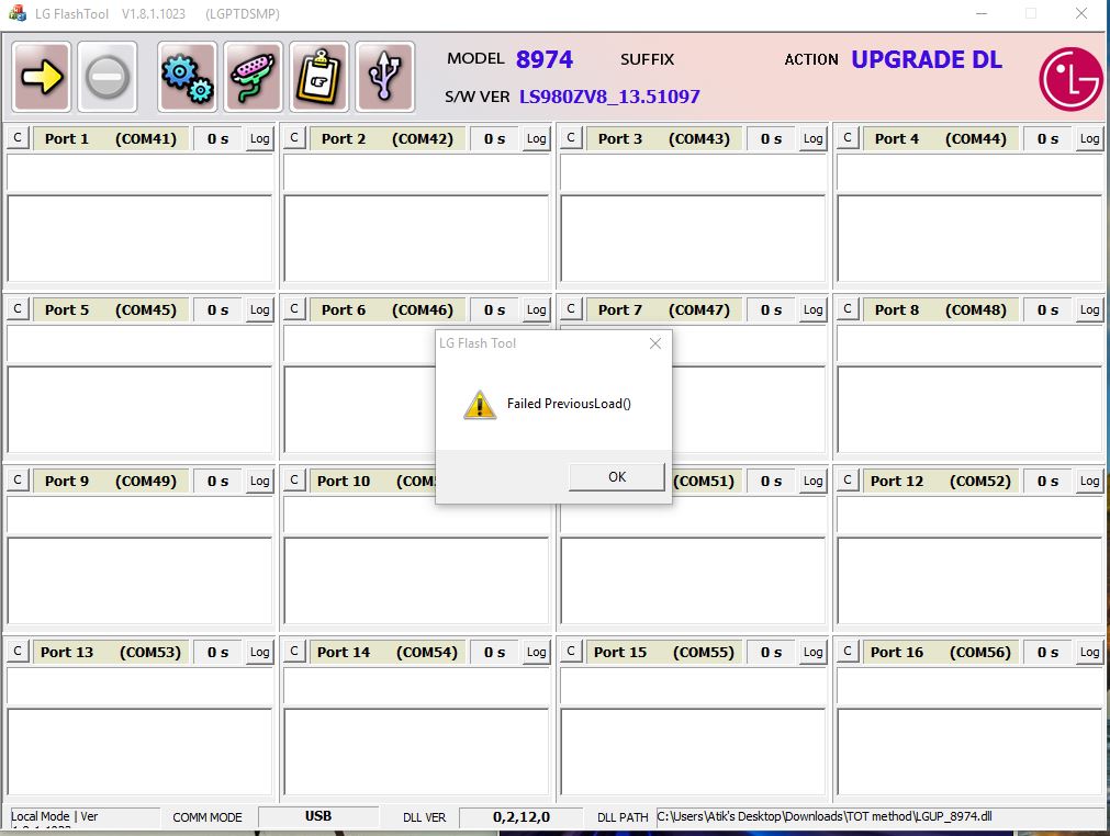

after fresh editing .tot and usin LGUp_8974.dll i got these:eek:

after fresh editing .tot and usin LGUp_8974.dll i got these:eek:View attachment 96769

See how the model says 8794 in your screenshot above? That is not correct. I wonder what's causing that?
In the hexeditor screenshot...is that the first instance of the model that you're changing? So if you search for 980 that's the first instance of 980 that is found? It doesn't look quite right, usually there's more info surrounding the model and its immediately followed by s/w version.
