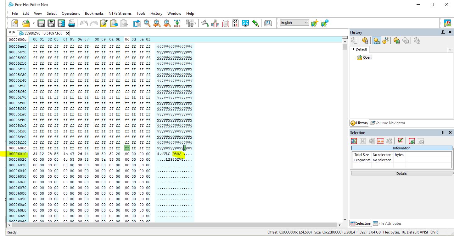

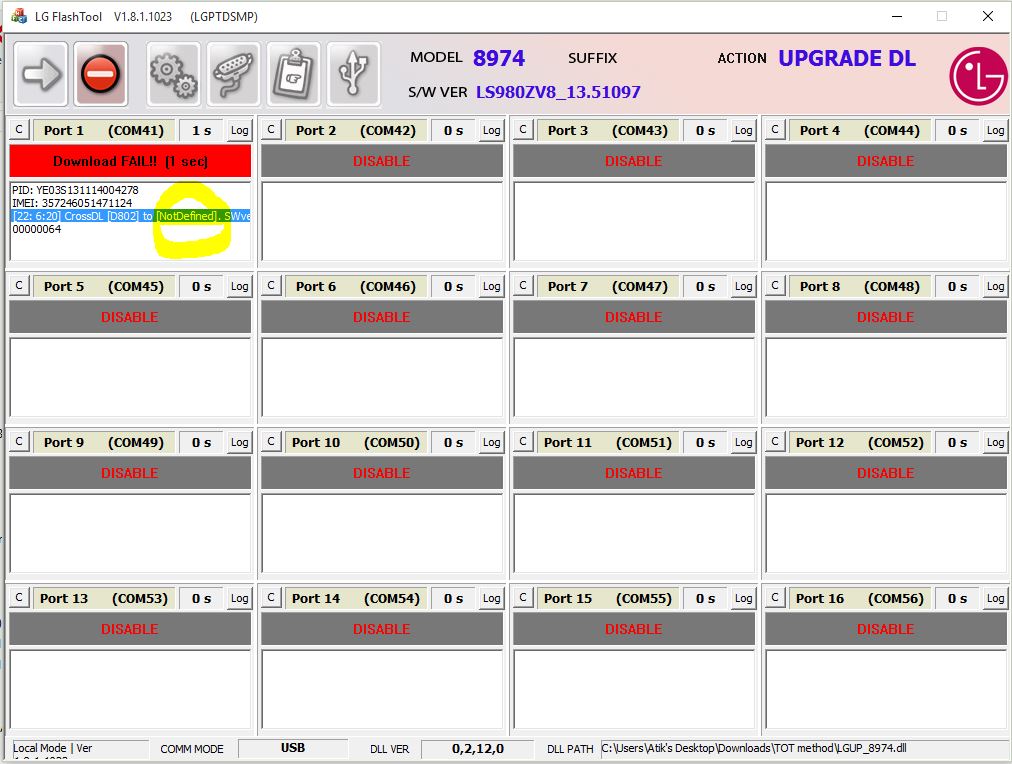

after fresh editing .tot and usin LGUp_8974.dll i got these:eek:View attachment 96769

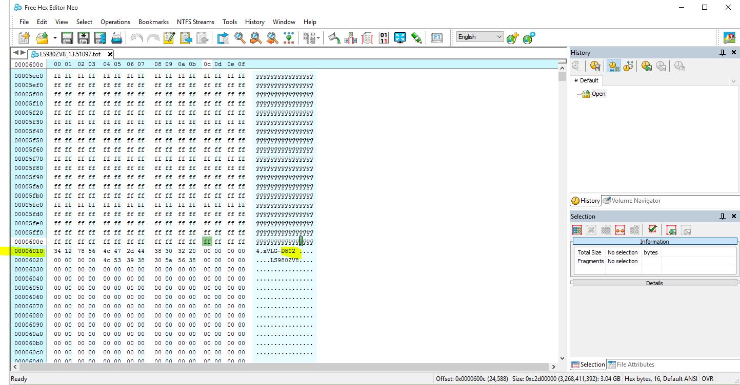

hex editorView attachment 96769 View attachment 96770
*** Do i edited it correctly?
************** i run WINdows 10,is it a problem?

See how the model says 8794 in your screenshot above? That is not correct. I wonder what's causing that?
In the hexeditor screenshot...is that the first instance of the model that you're changing? So if you search for 980 that's the first instance of 980 that is found? It doesn't look quite right, usually there's more info surrounding the model and its immediately followed by s/w version.
Can you give me a screen shot how to edit exactly , i think if change one 'dot' flash tool get error..

OK so you want to take your LS980 tot and hexedit the first instance of the model to read D800. As you have found, you are starting with 5 characters (LS980), and you need to end up with 4 characters (D800). So do do that, you must place a blank byte (00, also seen as a period in the viewer pane) directly after the D800 to make up for that 5th character while also not shifting any of the other bytes out of their original positions.

This is my screen shots.... This is the error i get in flash tool.Pls check my hex editor if i m wrong let me know
That is not correct. In the view pane on the far left, you should have another period or dot directly after the D800 instead of the blank space. A period represents a blank byte. If you still cannot get it after further tries, I can download the tot, make the edits and post a screenshot. But I will be away from my PC for the next several days due to the US holidays. It will be next week for that.

I was able to sneak in some last minute work. Here's what it should look like when complete. I highlighted the D800 and the . after which you can see is represented as 00 or a blank byte. Yours should look identical to that. Make sure everything to the left and right is exactly the same in that row also:
http://imgur.com/okehJ4Z
Also, it looks like we were using the same tot...LS980zvc_12. If so, it also looks like you MAY be editing a different instance of the model number than I was. Note the partitions are listed underneath the model number in a staggered fashion. Make sure you're editing the right one. Search the tot for the very first instance of "980". That should bring you to the correct location straight away.
