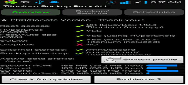

I uploaded a snap shot of the stats on T.Backup
Ric
Try koumakernel, move dalvik, clean up old text messages and keep email sync history low. that is, until I can get the betas to work and we can move the last of the data folders. i'm on vacation for another week so I don't think that will be too soon.
