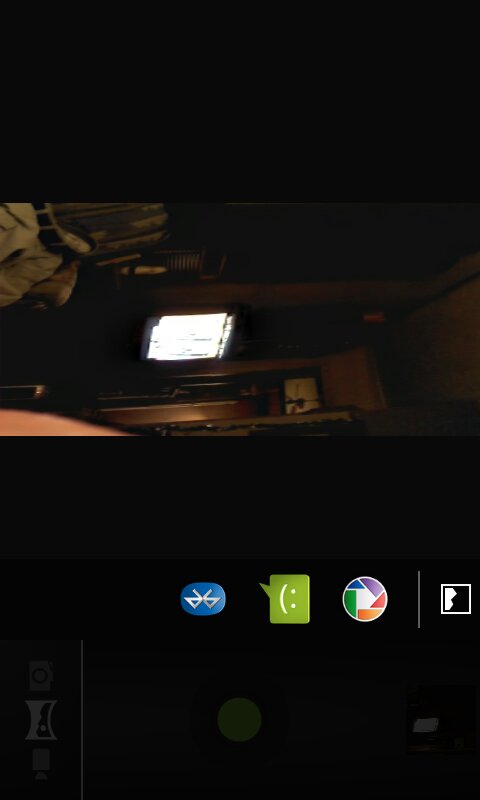

My god, I took a picture(panoramic) with this build 12/31/12 and it saved it. AWESOME JOB GUYS!!!!!! Thank You bsydz, g60.
