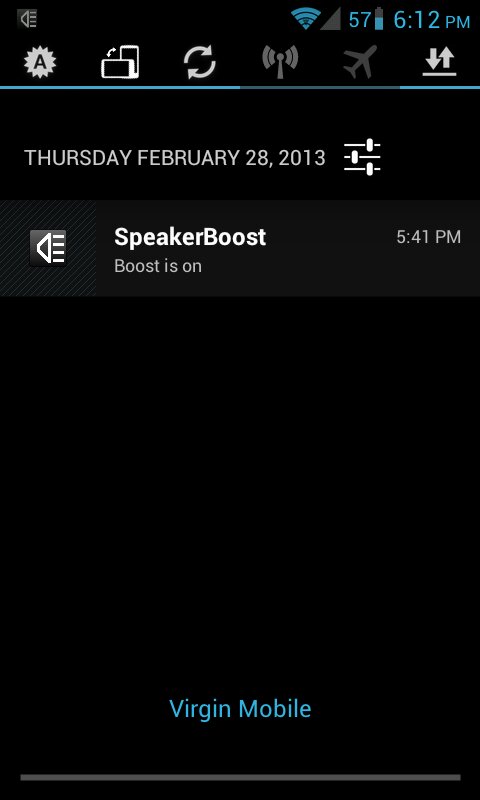

Tried it, it's a bit useless the times I tried using it but I think the roaming happens when in low signal places, other than that it's bulletproof with wifi on.
