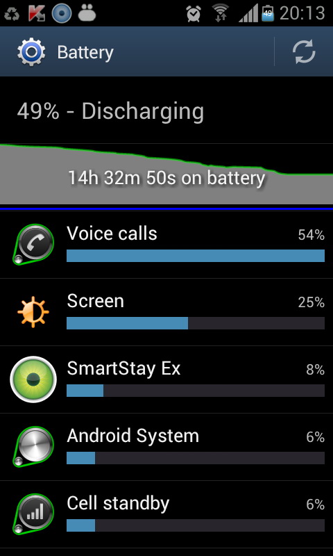

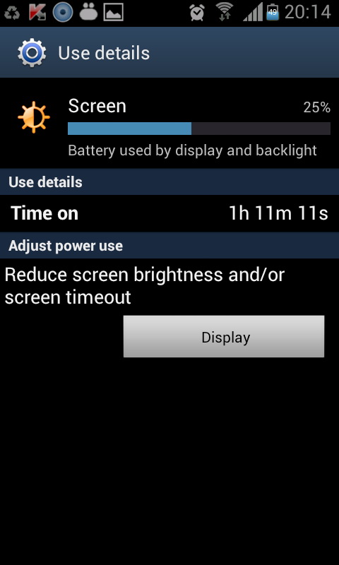

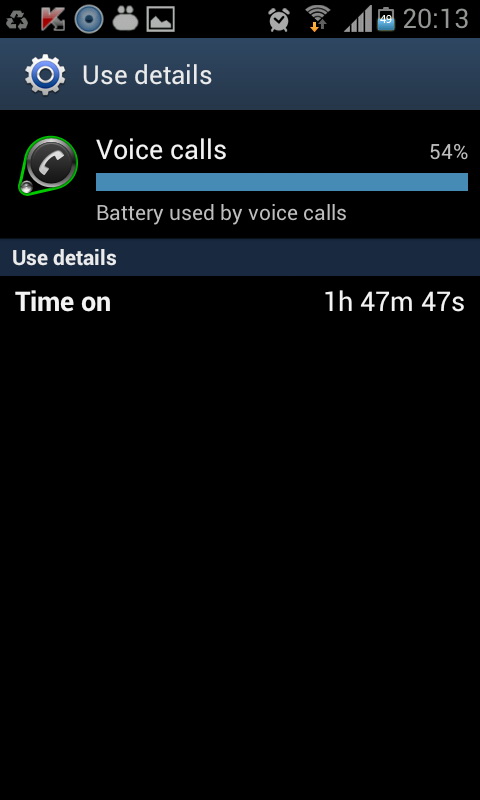

Thanks ironass. I used to get very good results with 5.89 (pics attached,old ones). I`ll let it settle for a day or two and post back.
I`m using extreme_battery profile, conservative for on/off with sio scheduler, all the other settings as you mentioned.
Now..after going back to 5.89, STweaks is still the app in charge. Shall I take it off and go back to ExTweaks or keep it with all the mentioned settings????

Thanks ironass. I used to get even better than that with 5.89. I`ll let it settle for a day or two and post back.
If STweaks works for you... then fine. I found that on v5.x that ExTweaks was better for me when it came to setting the Profile.
Judging from your screenies and my experience, I could not get that sort of battery life on v7.x.
