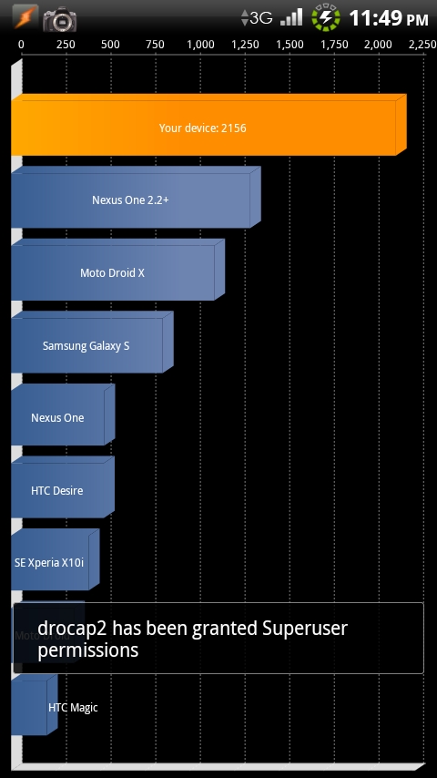

Just got a 2156 quad on 1.45ghz
edit:
attachment.php
