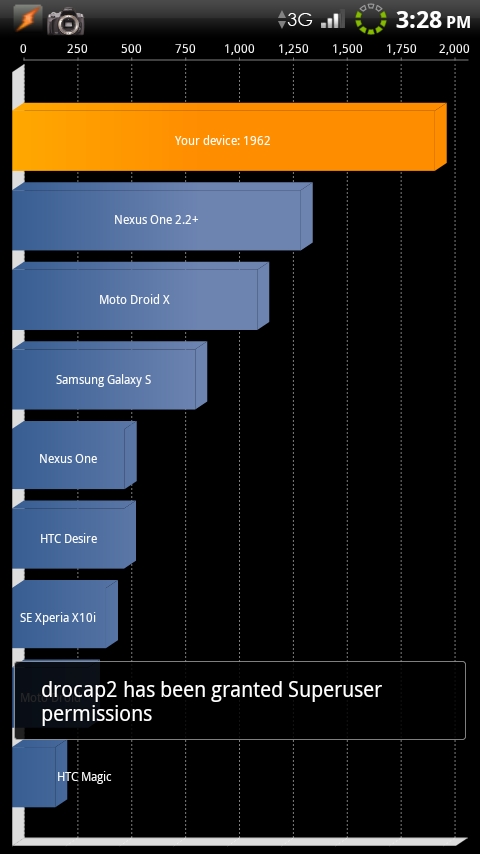

I just took over the number 8 spot with my 1931 qadrant...sweet!!

Quandrant 1815 and 1810. Only done 2 runs, so it's not bad.
1.42 GHz, for now.
