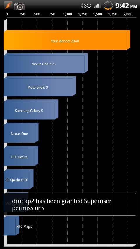

Just for kicks...
1.3Ghz with stagefright turned on.
r u on a DX? how did ur score get way up there?
