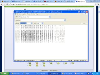

hello i am a noob here...using QXDM when i input this 0x00FCD950:this is what it shows 75 A8 F9 1E 00 00 A0 00 DD D5 AD 00 E1 D5 AD 00
do i have to zero out all numbers starting from 75 all the way to the 00 or are any specific numbers that i have to zero out . thanks in advance. same question for esn ???
First you need to know your esn, and meid if you have not done so already use QXDM and put in the password it tells you, then type in requestnvitemsread meid, and requestnvitemsread esn
once you have those numbers, write them down so you can refer back to them multiple times, you will then see which numbers you will 0 out.
In your case listed I am guessing you will only do the 75 A8 F9 1E. that will probably be your esn. Well technically pesn you will see it listed as 1EF9A875 when you do your request esn.
