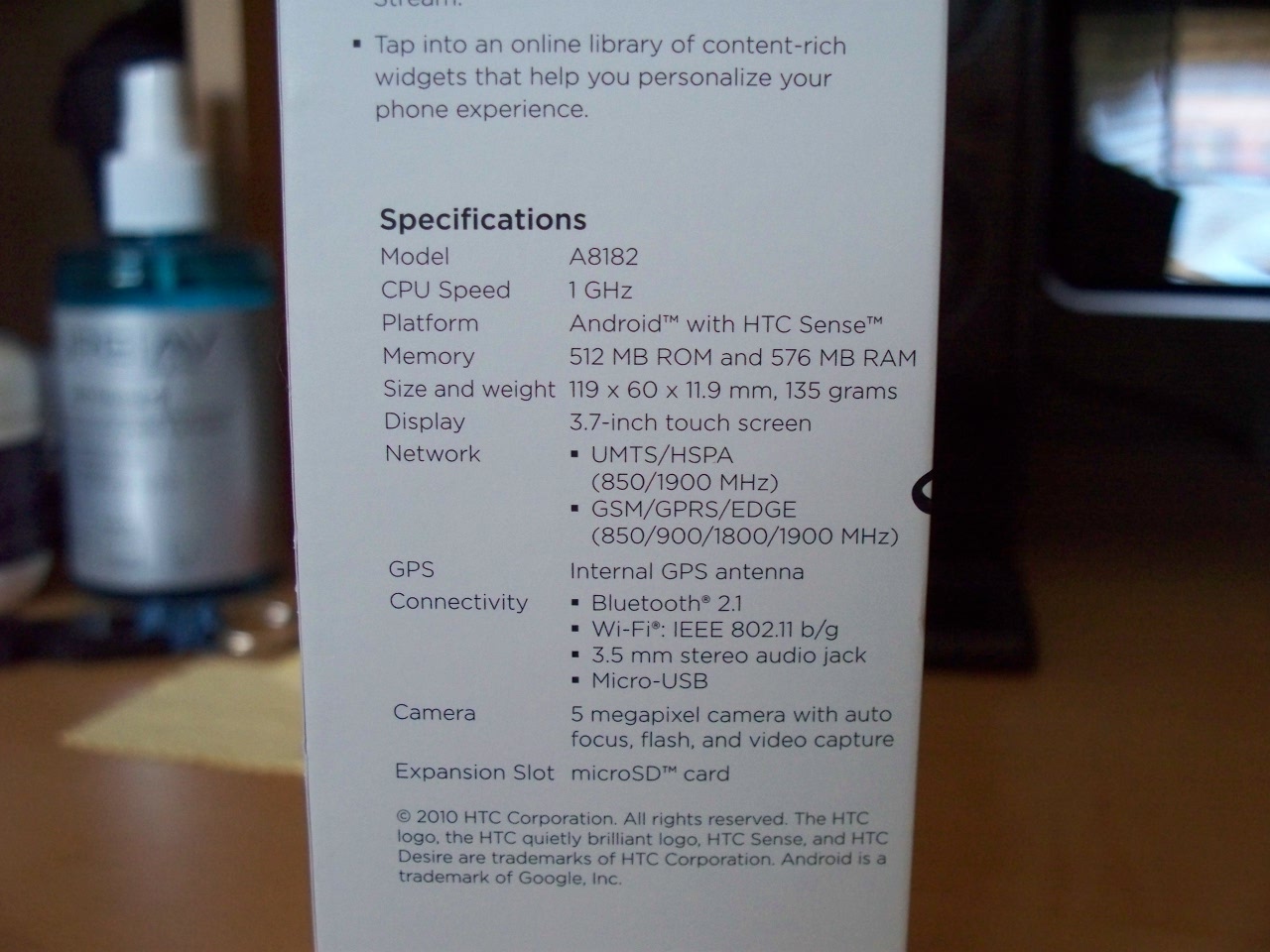

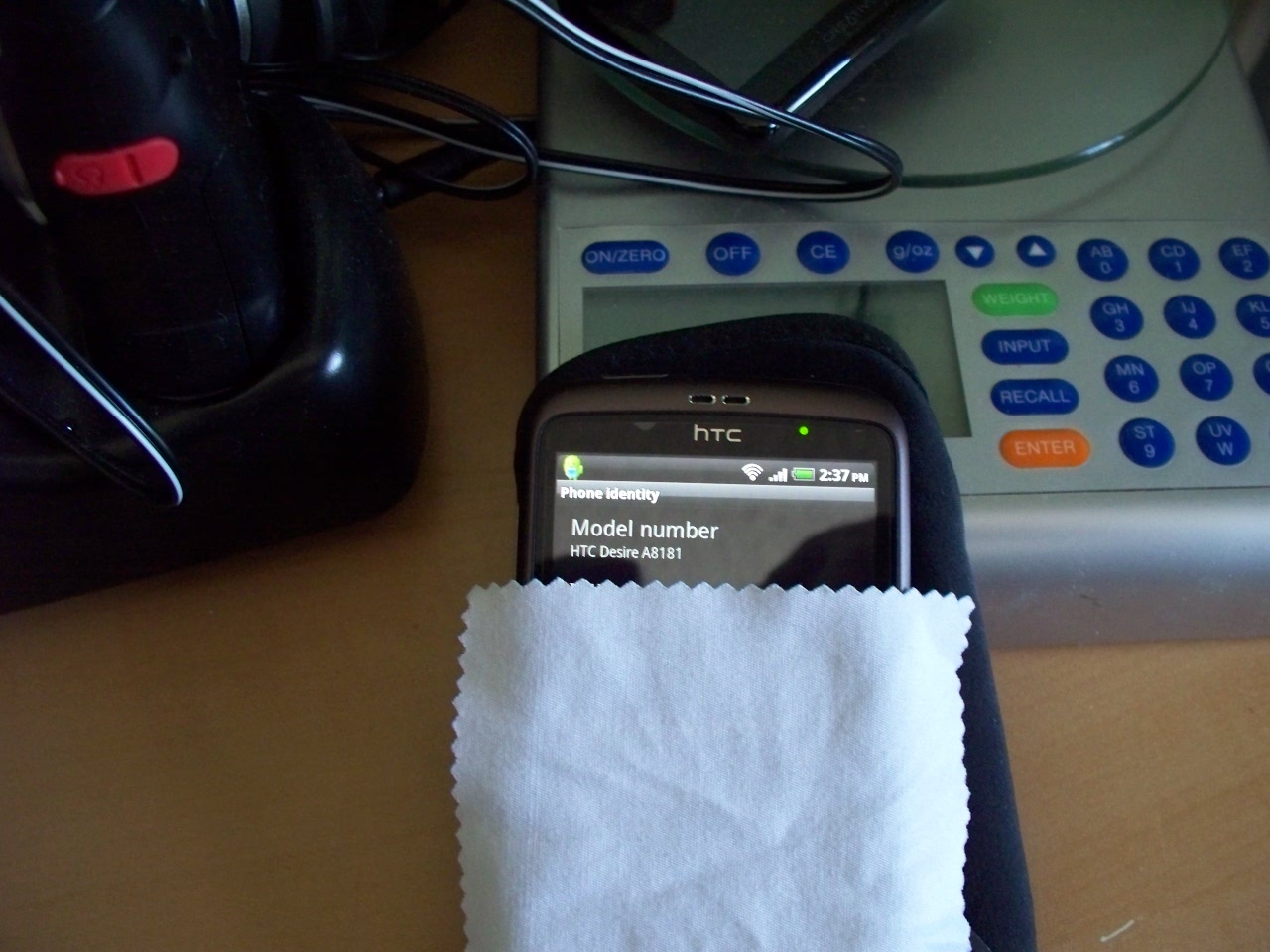

I have a question? I purchased a Telus unlocked desire the A8182 and then flashed the rom that is on the first page and after checking the phone identity it now says that it is the HTC Desire A8181??? has anyone else had this happen with their phone and would this newest ROM possibly return it to the A8182???
Lastly would it be a improvement to flash this latest rom on my phone, when I start it up it takes a minute or so to get the signal from AT&T???
Thank you for your time and also for this wonderful thread it has been very helpful to me.
The a8182 is a HSDPA/WCDMA: 850/1900 MHz
Quad-band GSM/GPRS/EDGE: 850/900/1800/1900 MHz
The a8181 is a HSDPA/WCDMA: 900/2100 MHz
Does flashing the RUU change the operating frequency of the a8182 to that of the a8181? If it does change the operating frequency, then flashing to the stock RUU may not be a good idea, especially for Telus users as their 3G+ network runs on the 1900/850 MHz frequency bands. I apologize if I sound paranoid, but I want to be 100% certain that this will not have any negative effects before I install, because as i read it, i wont have the option to go back after i flash.
edit: AT&T also uses the 850/1900 MHz frequency bands.
From what I have tested no it did not change the bands in the phone because when I put the phone into GSM only it connects to AT&T 850 Edge network and when set to WCDMA only it connects to the 1900 3G bands so no it does not change the bands just the markings from A8182 to A8181 this is very strange at best.
Here are pictures of the Box and phone screen showing the change.:confused:
