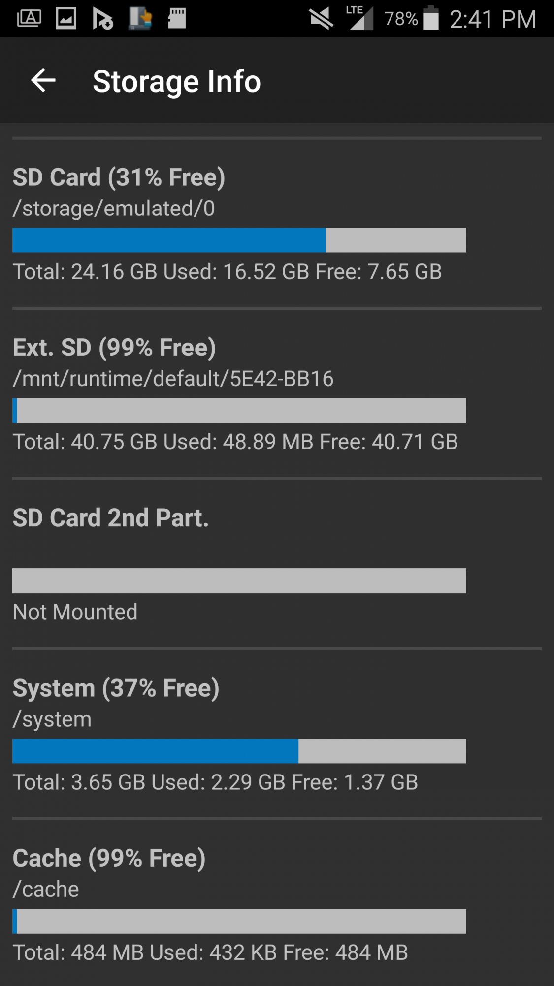

Link2SD display the same as your image but Im possitive I have not partition my external sd. I believe that the last time I had this working that it is displayed as another and separate part.
So you see we have the same space size?, and you haven't done the partition yet, have you???..if you haven't, why do we have the same size in the internal partition..all that means that swap thing doesn't work, does it???..
You finally see my point???

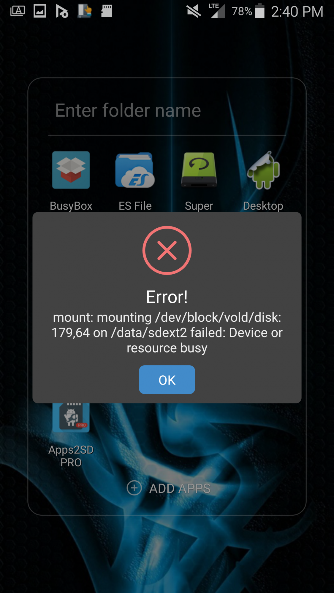

IDK, I haven't done this in 3 years. It did not work when I got to 6.0 MM. I was just explaining what I was planning on doing. I didnt realize you were going to start before I had a chance to test it first. In fact, In one of the previous post you stated that you didnt find this of any use. Next thing I know you had already started.
I need time to figure it out and am not sure if this wed ill be successful. Systemless root prevents mounting the bash/scrips before boot as App2SD indicstes in a fail.
Right now, Thats my bigest obsticel. This is what Im looking at right now. Heres a programer trying to do a somewhat similar endeavor but for different purposes. Check out the script that the wrote. Hes having a fail issue aswell and thats because he know how to program, wile I do not. Hes asking what he did wrong when writing this script. My answer is "I haven't got a clue" and no one provide him with any suggestions.
https://superuser.com/questions/128...startup-time-before-mounting-disks-from-fstab
I could be by adding it to .intd and provideing a directory path. App2SD provides a way of installing mount at boot threw TWRP but I fear DM-Verity or DAK fail. It all a bit frustrating. when I did have virtual ram. It was didplayed as a separate indicater on both App2SD and Link2SD. It was not a combined total.
Even when as far as to grand a dangerous permission (UID) and it still doesn't work. Sometimes it will take a week or two to figure it out and usually if it ends successful I have no idea what combination ended in a successful result.
In this case, Im focusing on the mount at boot. I believe that is the first issue that need to be resolved. I just am not sure how to go about doing that with systemless root.

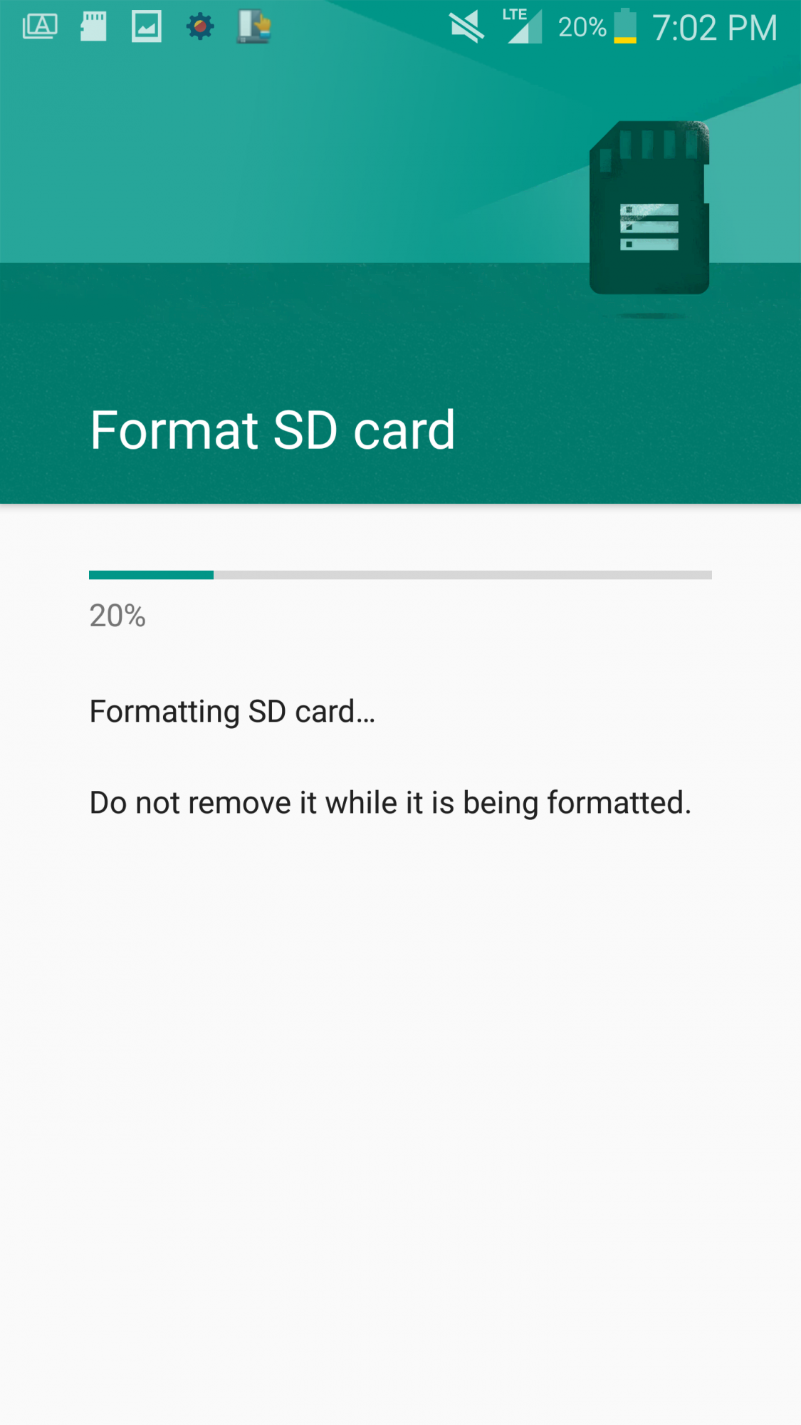

This is something Im testing not suggesting. Just an Idea that perhaps if I partition the size without formating the first partition. Lets say
25Gb without formating, the format the 2nd in Fat32 in 40Gbs and 1 Gb vertual ram.
Edit : didnt work , oh well
I understood your point before but what you asked was something I did 3 years ago.
I think you are right..because I remember back then, taking a picture and the whole screen wouldn't fit in one single shot..

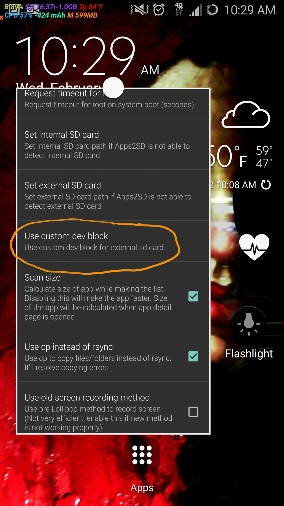

Hey brother I forgot to mention you some people said if you do the extension number 2 you will get issues have you tried the extension number 4?
Hey have you tried the apps2sd app..I don't want to accept but that app has way way way more options compared to link2sd and is also way more complex and has some options related to the issue when mount the second partition extension..
