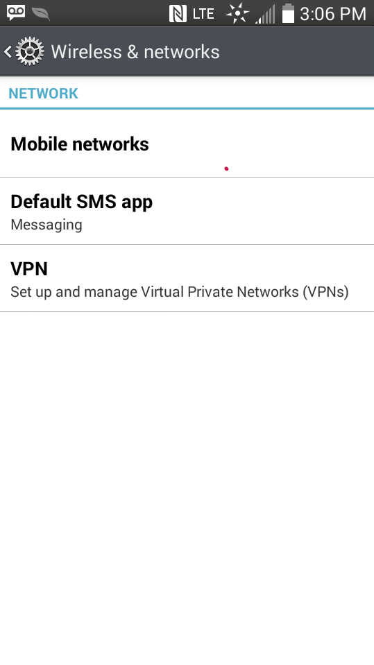

After i did this, everything works but now my hot spot feature under Wireless Networks is missing. Did i do something wrong? I tried using Wi-Fi Tether Router and it works but it's very slow.

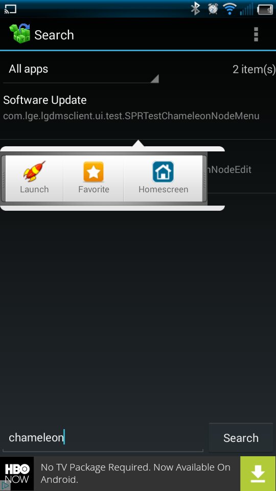

No, you didn't do anything wrong. To get it back, download shortcut master and search the term chameleon. Launch the node menu and scroll down to Tethered Data. Set it to 2 for Wi-Fi tether, or 4 for Wi-Fi and Bluetooth tether.
