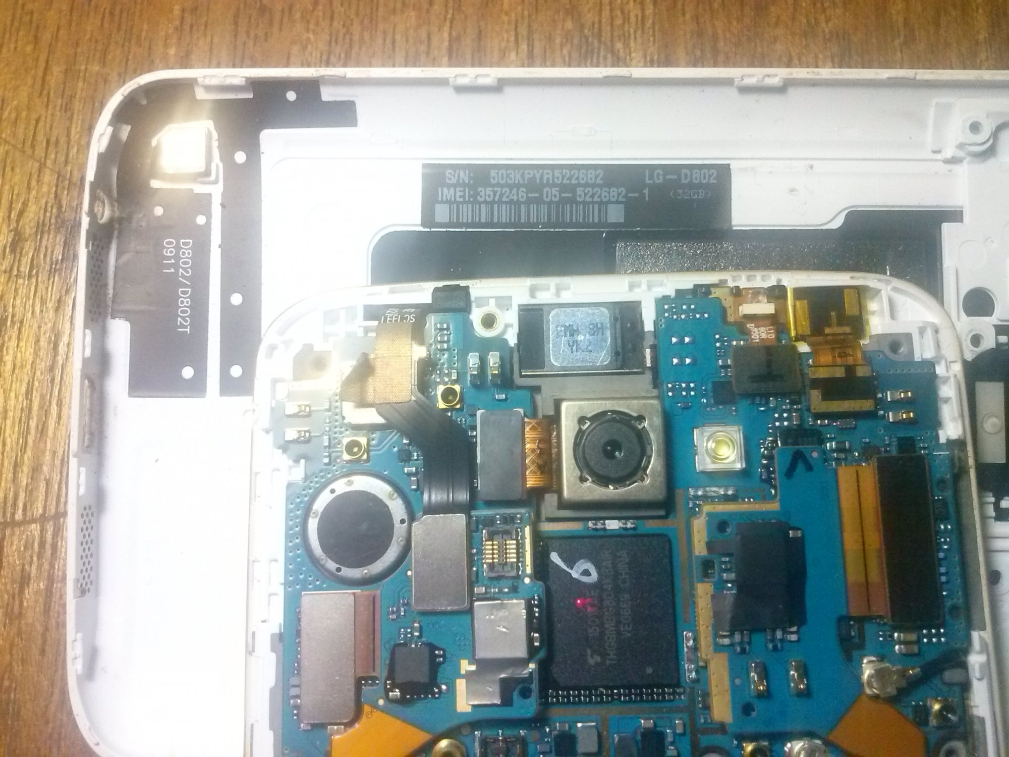

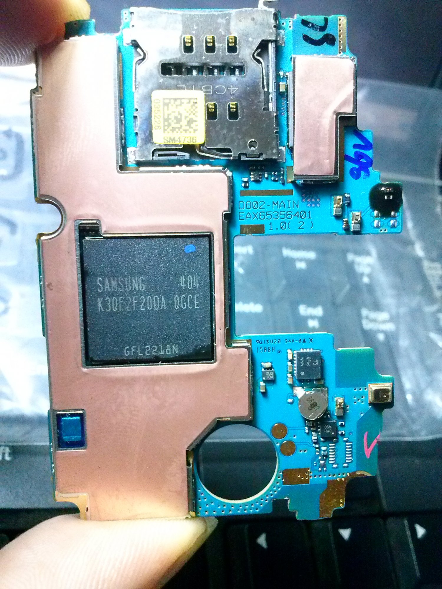

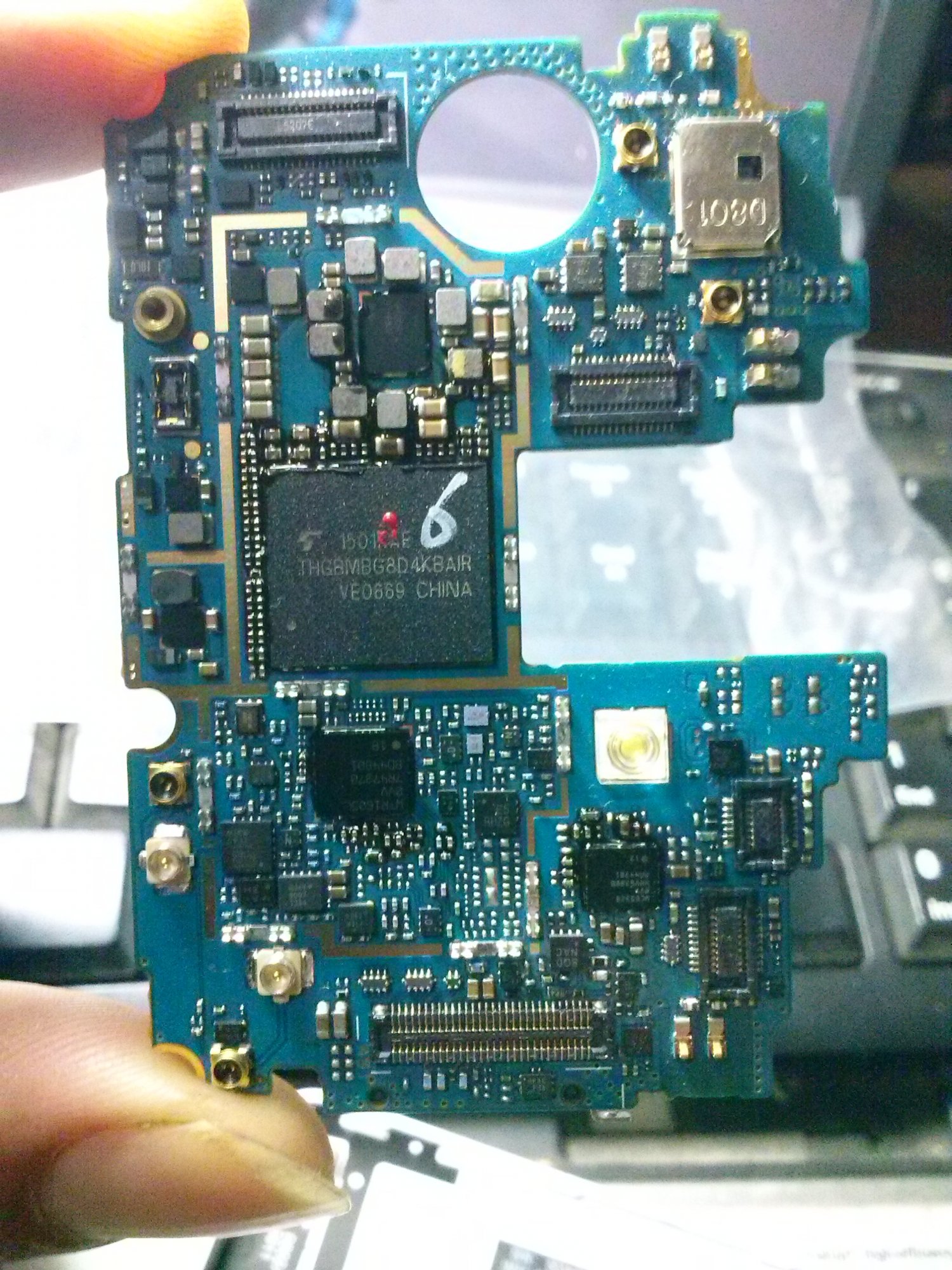

Since you've done the test point many times, pull your motherboard and verify the model stamped on the underside of it to be sure it's a D802. Most people who land in this situation with "D802's" come to find out their motherboard is a different model and that matters when trying to fix.
well..I'm sure it's D802..I open the mainboard..I see in the back..sure..its D802...
hmmm..What should I do Next???...:(:(:(:(
ok..this is the pic inside of my D802

You do not need to open your phone to fix this issue... if phone show QHS USB 9008 then it can be fixed. there is a tool to fix that issue... DO NOT OPEN PHONE..
The reason for opening the phone in his case was to verify that it's a genuine D802 and not a refurb with mismatching motherboard. I'm aware of the tool to fix as I've had it since before it was publicly released. But we don't want to go flashing the wrong model's partitions. ;)
