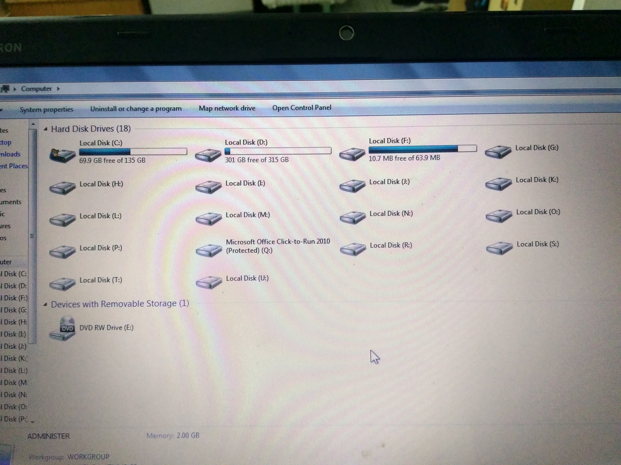

Okay. Finally. For the first time my phone does connect to the PC. But it shows under driver software installation that
USB Composite Device - ready to use
QHSUSB_BULK - no driver found
USB Mass Storage Device - ready to use
Qualcomm MMC Storage USB Device - reafy to use
It says that QHSUSB_BULK driver isn't installed but it still shows the numerous drives (I don't know what that means). What should I do next? Follow the same guide as for a QHSUSB_BULK error (as on http://androidforums.com/threads/lg-g2-d800-bricked-soft-bricked-back-to-brick.953331/)?
View attachment 116512 Okay. Finally. For the first time my phone does connect to the PC. But it shows under driver software installation that

There is a qhusb driver posted in one of the threads here. That would show you the exact error code. But I can tell you already that you are in 9006 mode. So yes, you can use the same advice I just posted to the previous guy. The srk tool from XDA.
Edit: here's the link for the qhusb drivers:
https://www.dropbox.com/s/3hovx8h7nauy7e6/Qcomm_Drivers.zip?dl=0
Instructs for driver install...unzip into a regular folder on your desktop. Go to device manager, right click on qhusb device and manually update driver using the entire folder of drivers on your desktop as the source location. Windows will pull the individual files it needs.

Your phone was showing up as being in qhsusb_bulk (9006). That's why all the extra partitions were showing up on your PC. So while in that mode, my advice was to use the srk tool from XDA developers site. I linked it several posts ago for another user having the same problem as yourself.
You don't have to know how to use the dd utility when using the srk tool as it does it all for you. You just select your model and choose the option to fix a 9006 bulk brick.
