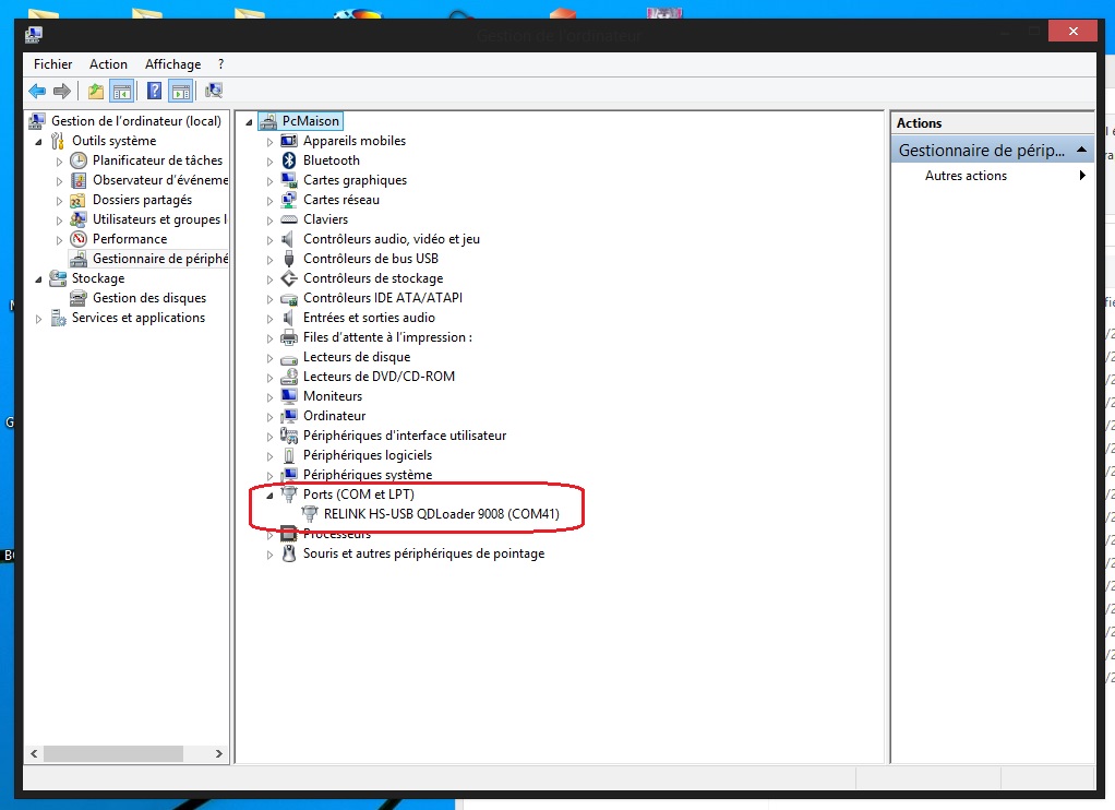

Hello hakim31,
I bricked my LG G2 32GB three days ago (Qualcomm HS-... 9008)
I succeeded with BoardDiag3.99c (with a 16gb tot file) then download mode + LGUP with a V30D Kdz file.
Now, my phone works fine with stock Lollipop 32 GB

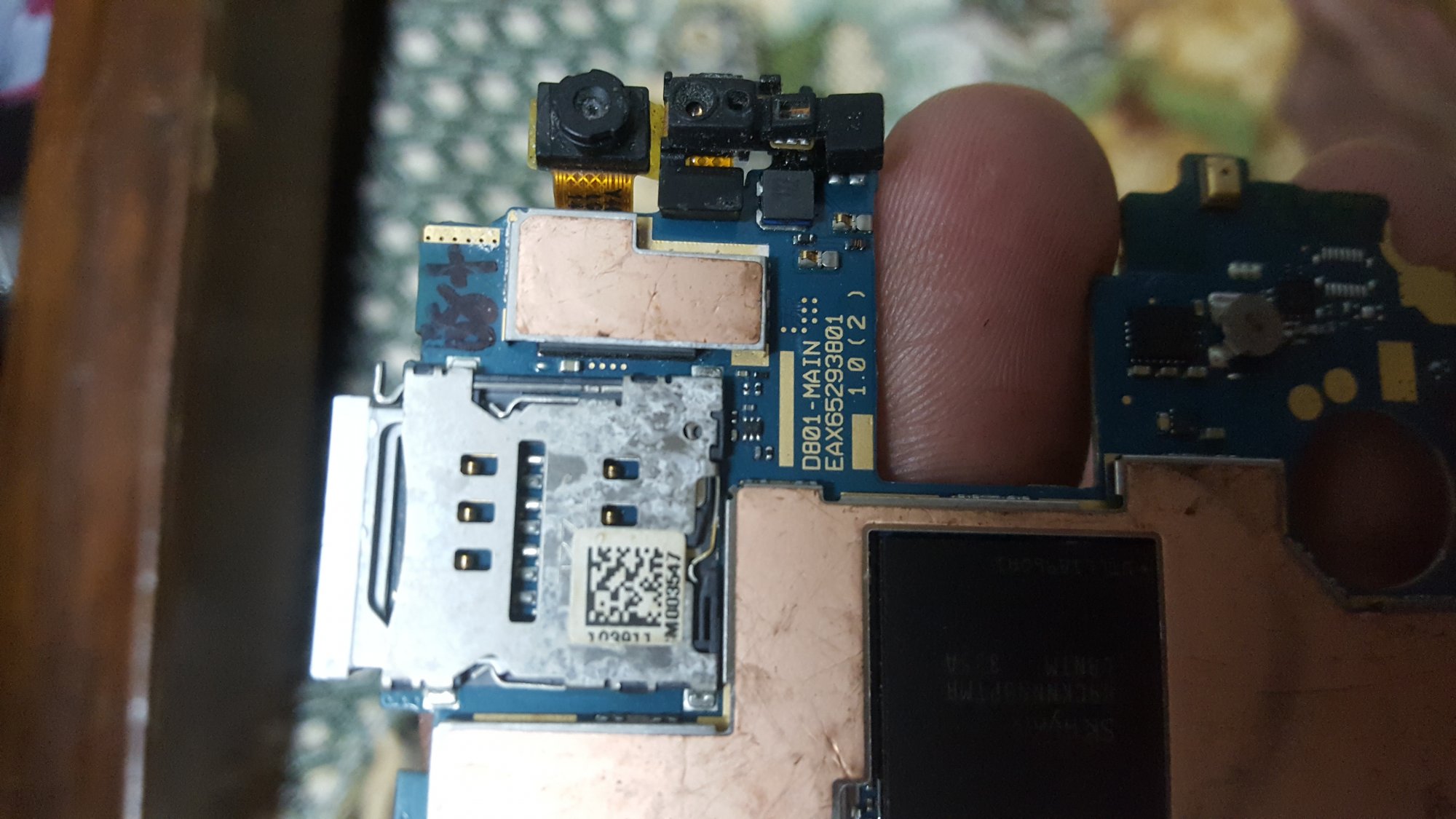

The reason for opening the phone in his case was to verify that it's a genuine D802 and not a refurb with mismatching motherboard. I'm aware of the tool to fix as I've had it since before it was publicly released. But we don't want to go flashing the wrong model's partitions. ;)
Sir my phone is D802 but internal written D800 and on ic written D801 !!!
so how can i will recognize my phone's model ??? plz
Use the model stamped on the rear of the motherboard. When you use the boarddiag tool, use the tot for the model stamped on the motherboard. Then flash all the individual partitions with that tool. It says "restore boot" as the default option but if you use the dropdown, you can restore all the partitions if you've already selected a tot as your target file.
Sir thanks for reply :)

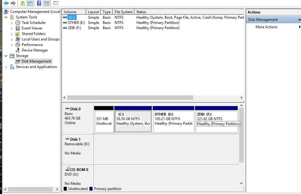

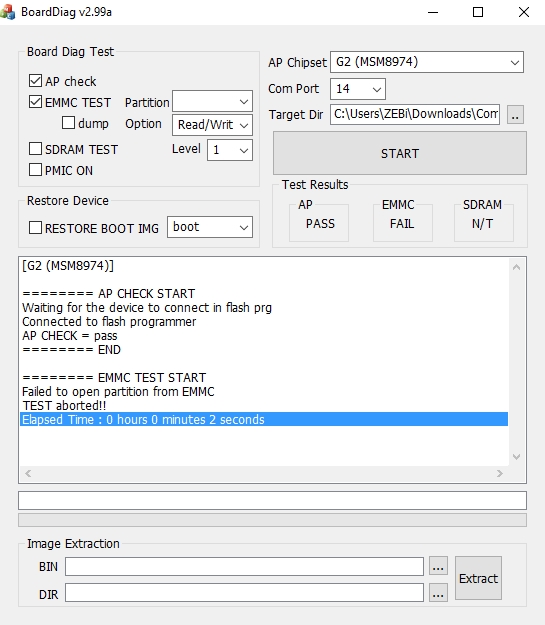

Sir it is D801 written on a board see picture sir i have downloaded tot files and extraction has been done on boarddiag v2.99a now when i tick on AP check and EMMC Test it gives me error emmc partition fail see picture.One thing more sir i have no partition show in computer management see picture
You can try flashing the img's from a d801 tot but it may not work. The emmc test failure could mean its corrupt or damaged. If that's the case you would be unable to continue.

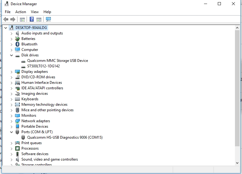

Sir i have remove 2 capacitors and short with tweezer now it is in 9006(com15)
disk drive partitions also found now what will be the next step ???
Partition Photo See >>>
