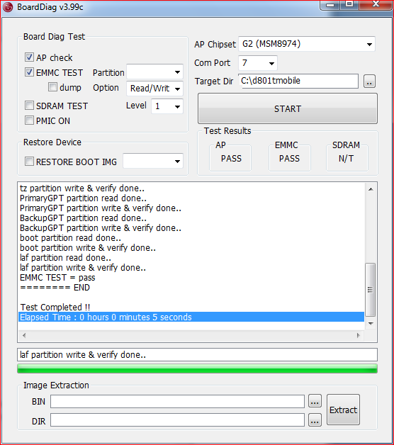

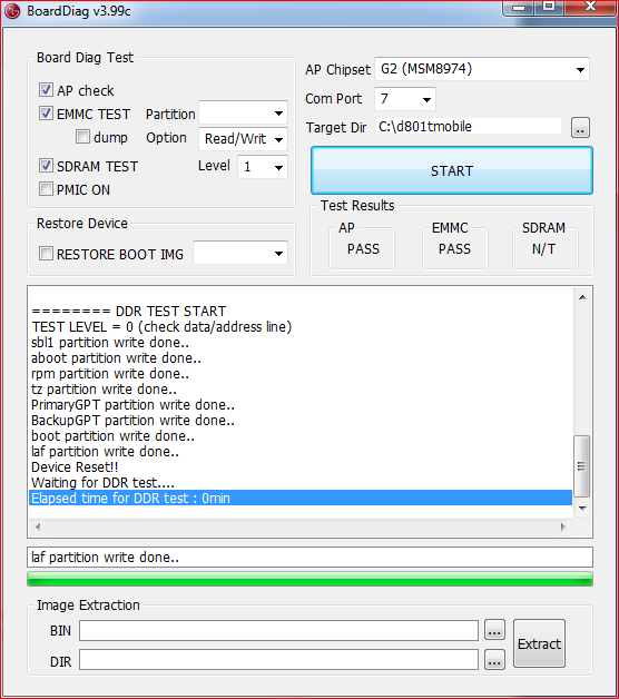

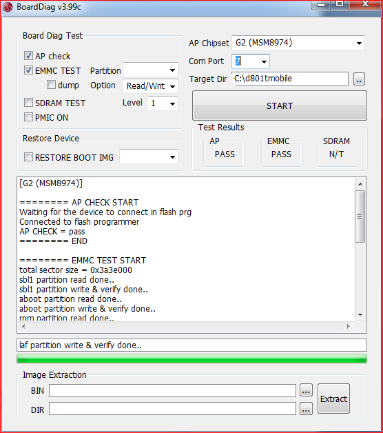

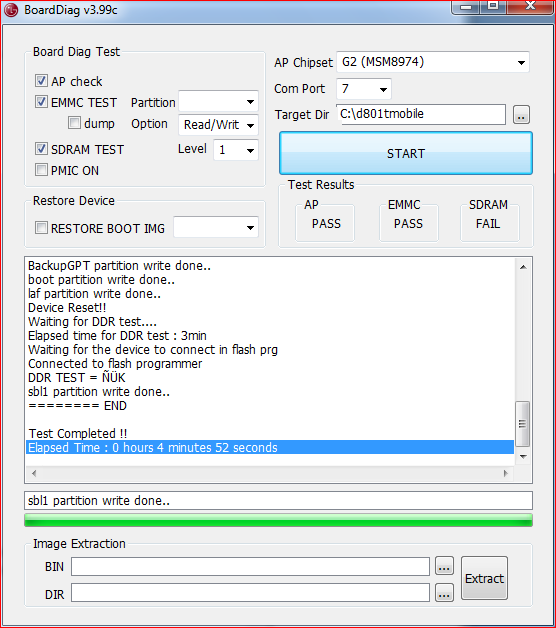

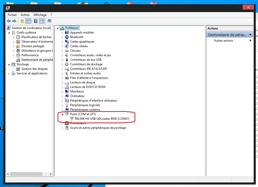

Any difference between RELINK HS-USB QDLoader 9008 and QUALCOMM HS-USB QDLoader 9008 My phone lg g2 d801 is recognised in device manager as RELINK HS-USB QDLoader 9008 and is dead no recovery no download mode when i try to use board diag v2 no result SDRAM test fail (capture666) and device not boot
okI can honestly say I've never seen one show up like that. What you can try though is to go to the restore device section of the tool, and in the restore boot img drop down, select every partition one by one and see if you can restore that way instead.

There is 9006 mode (classic bulk where the partitions should show up as "drives" in windows) and there is 9008 mode (QDLoader). Sometimes 9008 shows up falsely as bulk mode in Windows depending on the drivers that are installed. Go ahead and install these drivers..
https://www.dropbox.com/s/3hovx8h7nauy7e6/Qcomm_Drivers.zip?dl=0
Then recheck how the phone shows up in device manager. The device description should now be more specific and will show if you have 9006 or 9008.
