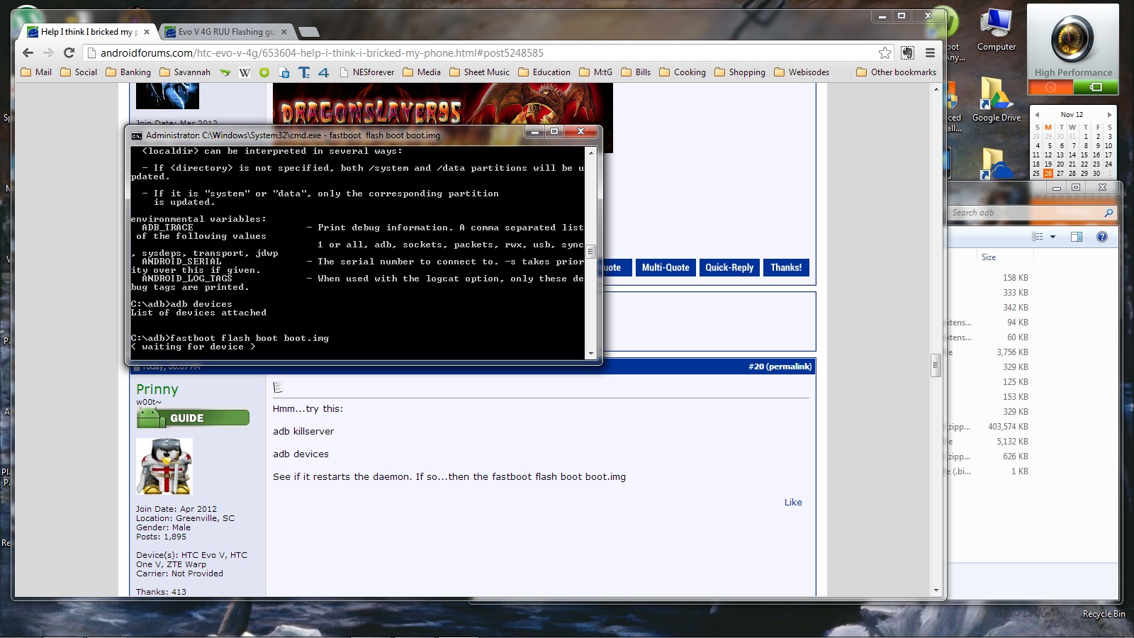

JustBenny2k, can you try flashing the boot.img again and take a screen shot and post it so we can see what your command prompt looks like? I will keep peeking in when I can. I have a busy night.

This is why I wanted to see your command prompt. Are you sure you're running the commands from the proper directory? And your phone says fastboot in red letters? Man if you were s-off we would have more options to recover. Try new cable. Disable any software that can interfere such as htc sync, iTunes....

Yes the drivers are installed and it says FASTBOOT but not FASTBOOT USB. I"m running Win7 and the software is in a directory called ADB which I am running fastboot from. I've tried 2 different cables, too.

Does this help?

Where did you get this version of the sdk? From the Android Developers website? Or is it some form of a mini-sdk package? Is adb the name of the folder that houses the adb.exe and fastboot.exe applications? You want to be issuing the fastboot commands from that directory unless you have input an environmental variable to adb/fastboot globally on your machine.
So if it were the full blown sdk and following the majority of install guides on the net, the location is often:
c:\android-sdk-windows\platform-tools
...that could be entirely different for you depending on what package you used and how the file structure is laid out. Just trying to make sure we're on the right jumping off point here.
Hmm I hope you don't have a bad usb port on your phone. It looks like you're doing things right but it is definitely waiting for device because fastboot usb isn't working. Other than faulty usb port, the only thing I can think of is if your computer is usb 3.0

I don't believe you'll have much luck running any adb command from the fastboot option in the bootloader. adb commands should be run from inside a custom recovery as they are packaged with an adb deamon.
Also, I think our problem may be either an incorrect download or an incorrect path when issuing commands. Is this the thread you downloaded your sdk package from:
http://androidforums.com/evo-v-4g-a...ing-evo-v-4g-roms-kernels-using-fastboot.html
Because if so, there are a couple options in there concerning adb/fastboot and I believe the last one MAY be adb only. So is that the one you installed because that would explain things and it'd explain why the folder you're issuing commands from is called adb.
If you installed the mini-sdk from that link, your path would be:
c:\ sdk-tools
...assuming you installed it on the root of the c drive and not on the desktop or similar. So, in any event, let's figure out exactly which package you have, then we need to drill into the folders (possibly your adb folder) and make sure that it contains both an adb.exe AND fastboot.exe.

Yes, that's the one and I renamed the folder ADB because I was tired of typing SDK-TOOLS. Too many letters. Are you saying I should rename the folder?
Sure enough, I just renamed the folder and now the fastboot menu says USB. Odd!
