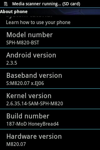

if you want your kernel version to say something else you can do this
change the top of the make file to look like this
FROM
VERSION = 2
PATCHLEVEL = 6
SUBLEVEL = 35
EXTRAVERSION = .14-SAM-SPH-M820
NAME = Yokohama
TO
VERSION = 2
PATCHLEVEL = 6
SUBLEVEL = 35
EXTRAVERSION = .14-GENOCIDE_187
NAME = Yokohama
change it to what you want, but after the .14-
you can only use 12 characters
you will then have to hexedit each of the modules you will be using in your ram disk
like this
before
Offset 0 1 2 3 4 5 6 7 8 9 A B C D E F
00025650 72 69 65 74 61 72 79 00 64 65 70 65 6E 64 73 3D rietary.depends=
00025660 66 73 72 00 76 65 72 6D 61 67 69 63 3D 32 2E 36 fsr.vermagic=2.6
00025670 2E 33 35 2E 31 34 2D 53 41 4D 2D 53 50 48 2D 4D .35.14-SAM-SPH-M
00025680 38 32 30 20 70 72 65 65 6D 70 74 20 6D 6F 64 5F 820 preempt mod_
after
00025670 2E 33 35 2E 31 34 2D 47 45 4E 4F 43 49 44 45 2D .35.14-GENOCIDE-
00025680 31 38 37 20 70 72 65 65 6D 70 74 20 6D 6F 64 5F 187 preempt mod_
Just a preview. ;)
